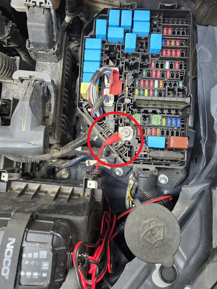

    It's eminently possible to connect a charger under the hood, either temporarily with the charger's alligator clips, at the jump-start point in the under-hood fuse box, or you can permanently wire a quick-connect to the point where 12 volts feeds into that fuse box. The negative connection can be to any convenient, bare-metal point on the car body, say under a bolt head.
    There are chargers that are external to the car, and some that mount under the hood, and an cord with plug is typically run out through the front grill (or you can get fancy, install a capped, plug-in port in the front fairing (aka bumper :rolleyes:). Aforementioned Noco brand has both styles of chargers.

    A trickle charger is a bad idea; they will destroy your battery eventually.
    A battery maintainer tests your battery periodically, and gives it a top-up charge as needed.

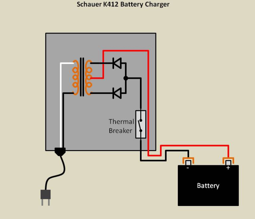

    In the old days a trickle charger was not looking at the voltage and current draw of the battery with any logic; it was just a cheap low current transformer with a couple of rectifiers. It might put out a poorly regulated 13.5v at a half an amp all the time.
    When you have a bunch of old guys in a forum, most never mechanics or electrical techs, you get some confusing language along with outdated knowledge from their heyday. It gets worse when they buy a Prius but can't sit still long enough to digest technical training like the Weber State hybrid videos.
    The first is available at your nearest estate sale

    ^This is a workable solution from @Paul Gregory. I ‘think’ the positive post circled calls for an M10 sized eyelet, others can correct me if I’m wrong. For the negative eyelet, a good metal-to-metal contact point on the engine or body as @Mendel Leisk notes. The plastic fuse/relay cover does need to be notched for the connection to exit, a small price to pay.
