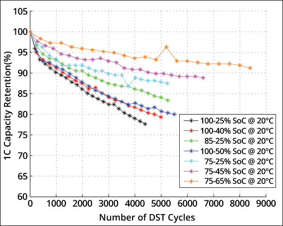

  8. Lee Jay
    Lee Jay Senior Member
    Jun 25, 2009
    5,850
    4,036
    Westminster, Colorado
    This is basically false.
    Even through the Prime battery's 0% and 100% correspond to something like 15% and 85%, narrowing the range further definitely increases overall life quite a lot as the above graph shows (compare green which is similar to the Prime's charge cycle) to blue (probably corresponds to not charging above 85% on the Prime meter), purple (corresponds to not discharging below something in the 20% range), and orange above the green line.

  10. bisco
    115,233
    52,740
    lee jay's graph has no basis in reality
  11. john1701a
    john1701a Prius Guru
    Jan 6, 2004
    12,840
    5,312
    Please explain the part of it you dispute.
    Looking at the range/distribution values, the results make sense.

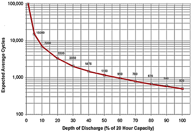

    What, do you think I made it up or something?
    How about these?
    Arctic_White likes this.
