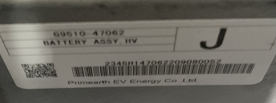

    is this a newer battery ? Came out of 2010

    Since the qr code is just not helpful, you would have to open up the case To verify

    place 7-11 in the serial number is the model number
    then:
    20th day of the 9th month of the year 2008
    =September 20, 2008?
    or it may be Aug 9, 2009 (which may make more sense for a 2010 model vehicle)
    sometimes I forget the exact order of those serial numbers

    Digit 12 & 13 are for year. Digit 14 is for month and digit 15 & 16 are for day.
    2020, september 8th
    Factory HV batteries from 2010 prius had older type sticker. This is a Toyota replacement hybrid battery.
    In 2022 the coding has changed.
