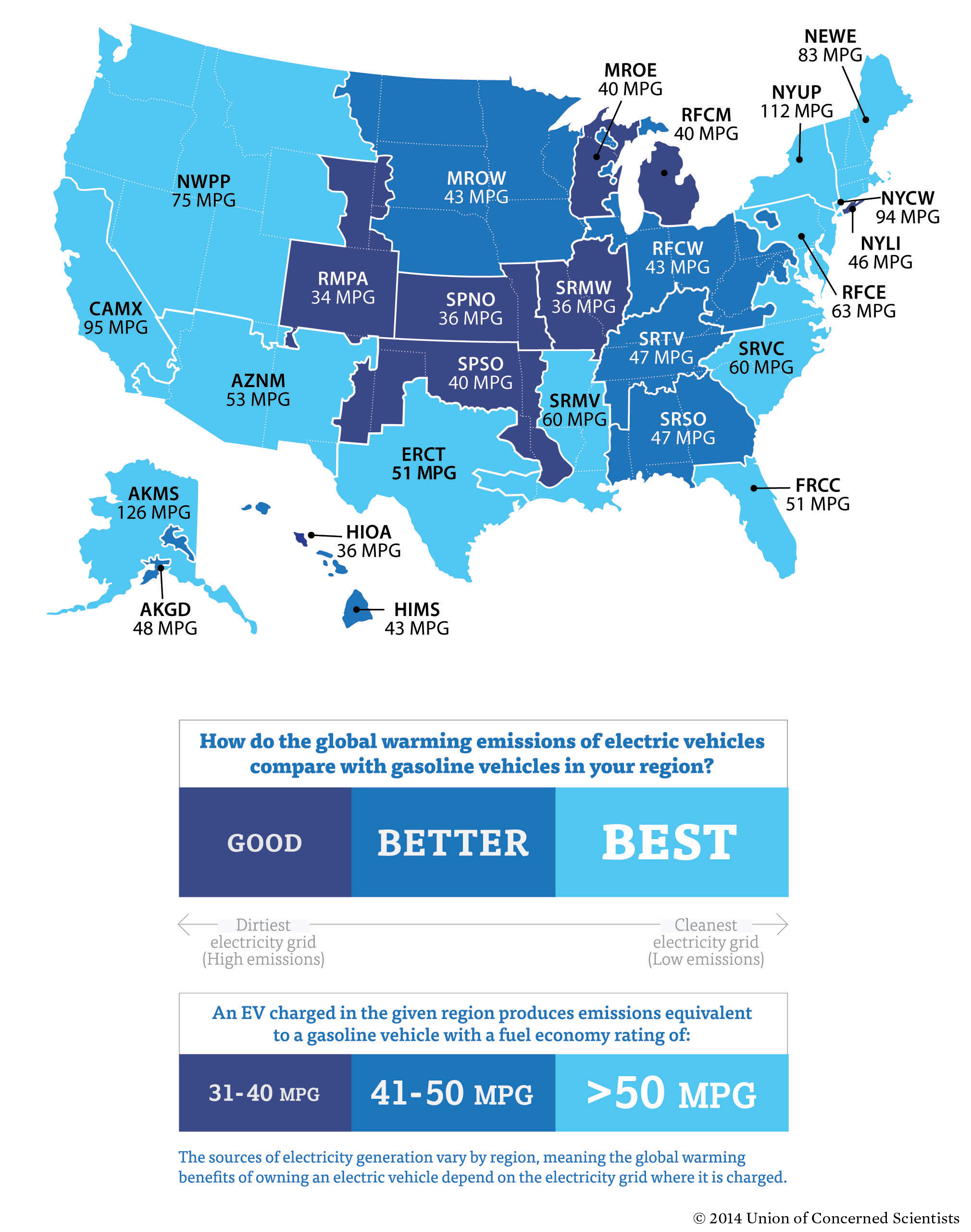

  3. Trollbait
    23,744
    12,833
    This map is from 2 years ago, and based upon the average efficiency of the Leaf and Model S.
    So the Prime will be better than the 34mpg equivalent CO2 emissions. Either way, a plugin will likely emit less CO2 than an equivalent ICE car in the US. Aside; what is powering Alaska's grid, hydro?

    Explanation needed, cannot see your deduction.
    Average ICE car - yes, Prius with 54 mpg - not in all states.

  6. Trollbait
    23,744
    12,833
    The full report can be found here; Life Cycle Electric Vehicle Emissions (2015) | Union of Concerned Scientists. It is newer than the map I posted, and Colorado is now rated 35mpgCO2eq.
    My deduction is based solely on the Prime being more efficient than the Leaf and Model S in EV mode. Using less electric means less CO2 emissions from the grid for the same distance.
    The Prius sold, IIRC, 110k to 120k units last year(2015), and it is selling less this one. The Corolla sold in the 300k's and the Camry in the 400k's. The F150 did over 700k. With plugin buyers coming from a mix of vehicle types, and not just hybrids or other high efficiency models, it is disingenuous to use the high outlier of the Prius as the measuring stick. At best, it diminishes the impact plugins have in reducing the fleet carbon emissions. At worst, it discourages someone from considering a plugin.
    In short, if everyone was buying cars as efficient as the Prius, calling out plugins on not being low enough in carbon emissions is fair, but the majority isn't being such efficient cars. That is why the average new vehicle sold is around 27 to 28 mpg, and actual car is 35mpg. Remember, those averages include the Prii sold.

    This source is simply saying that in Colorado (on average) all conventional cars with efficiency above 35 mpg are emitting less CO2 than the Leaf. Or (seeing the glass half-full) The Leaf emits less than all cars rated 35 mpg or less.
    No agreement or disagreement to @Lee Jay analysis of the prime EV/HV emissions, it simply talks about another subject.

    How is the CO2 emissions of using an ICE car vs a BEV charged by the grid a different subject than the CO2 emissions of a PHEV in hybrid vs EV mode?
