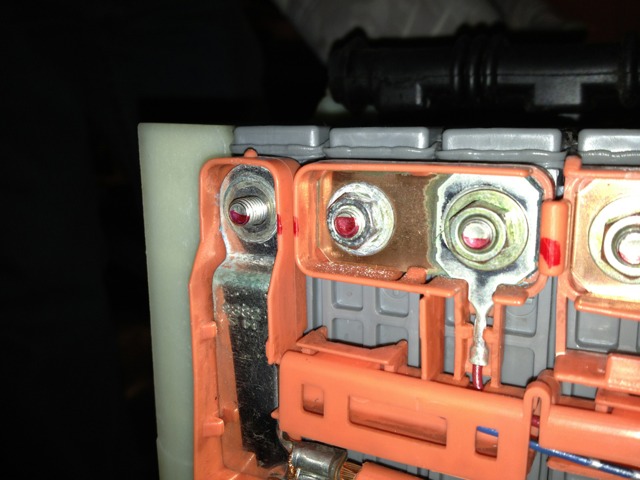

    Well, I found the problem. Right now I'm letting some of the rusted brass plates and nuts sit over night in some chemical solution. I'll reassemble this bad boy tomorrow and post an update. ImageUploadedByTapatalk1373950209.212736.jpg

    My Prius runs now. If anyone's curious, I found an extra nut and screwed the metal plate in tight. The car threw out 2 more error codes but disappeared after I nudged the battery a bit. I saved $5000, spent $50 on a new battery cell, $24 on a multi-meter, and $50 on OBD II reader.

    Your photo in post #31 shows a missing nut on the far left. Is that what you were referring to? If so, I can see why your battery would not operate.
    Also, what does it mean to "nudge the battery a bit"?
    What chemical solution did you use to clean the busbars?

    According to the picture above it looks like a main connector on the battery.

    That is correct. There was no nut, therefore the terminal did not have have any contact whatsoever to the battery, thus no power and dead car.

    Was the missing nut found? How long had this been a problem? You originally stated "...so I bought a new cell to replace the broken one. " Was this nut missing at that time or was it left off during that repair? Just trying to learn more about the cause of this incident.

    It's no problem. The nut went missing during the repair and for some reason, I didn't bother to replace it. Fast-forward 2 weeks later, I realized that nut was missing and grabbed a regular nut of that size and screwed it tightly in. Voila.
