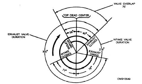

    for the gen 2 Prius[​IMG]

    Range 5 looks "good" - the engine doesn't seem under heavy load - (RPMs) aren't always "high" cruising 70mph.. I'm guessing the RED is the overlap?
    Pardon my ignorance, but how could one tune an intake to +70mph with the picture you attached. I honestly don't know much about cams duration and such...

    Firstly, I am not confident one can 'tune' an intake runner on a Atkinson engine, there will be reversion in the runner due to the late intake closing, rather than a sharp wave at closing in an Otto cycle.
    HowStuffWorks "How do tuned intake runners work on your car?"
    On a 4 stroke engine the crank revolves twice for every power stroke so I am not convinced the red area is overlap, I think it is the small area at the very top, where the exhaust is closing but the intake is opening. Load 3 and 4 seem to have overlap.
    This is a random Otto cycle camshaft with overlap labeled.
