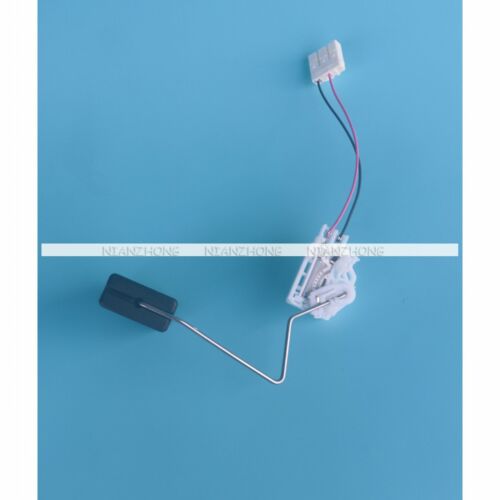

    mr_guy_mann,
    is this is the part need to be replaced ?? and can I do it by myself ?

    NJ-USA
    On a Gen2 that was made for the US market, you have to replace the entire tank.
