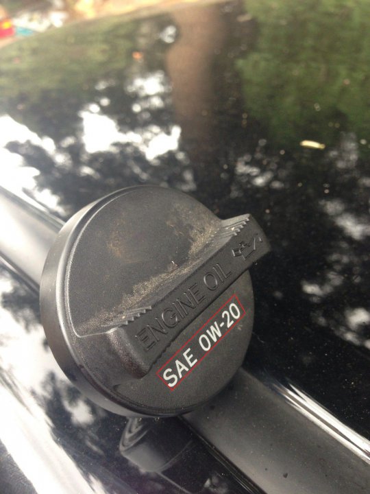

    Greetings!
    Had my vehicle serviced at Toyota Chadstone yesterday and they had my prius 2013 filled with 10W-30. Isn't 10w-30 especially bad for the engine during the winter? Wouldn't it impact on fuel economy and cause long-term damage to the ICE?
    I'm fuming mad about this! The dealership kept on insisting that there is nothing wrong about having 10W-30 filled even though I told them SAE 0W-20 is the recommended engine oil grade.
    The service centre guy kept on arguing about this issue, instead of trying to find a middle ground, he went on to talk about his stupid 600HP car that is on 10W-30 with no issue. and told me I must pay $30 - $40 extra for synthetic 0W-20 even though I'm on capped price servicing.
    Got back home and I discovered that the engine oil cap that we had here is different from elsewhere! SAE 0W-20 isn't printed on it nor it is clearly stated in the owners manual that SAE 0W-20 is the recommended engine oil grade.
    What's gives? Do I have a case for raising a complaint to Toyota Australia?
