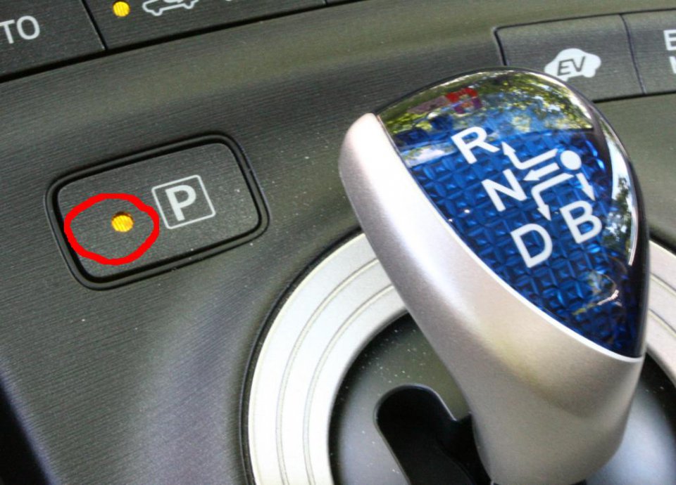

    I have a 2011 Prius, but I want to know if the LED light on the P Shfit Button is also dimmed when you dim the interior lights between daytime and nighttime with Rheostat Dimmer in your 2012+ Prius. Also, is the parts# 84718-47061? I think it is different than 2010-2011 as #84718-47020.

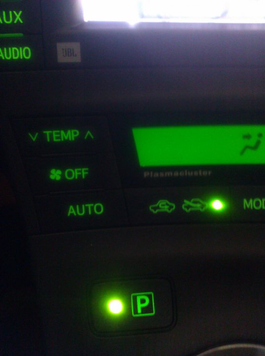

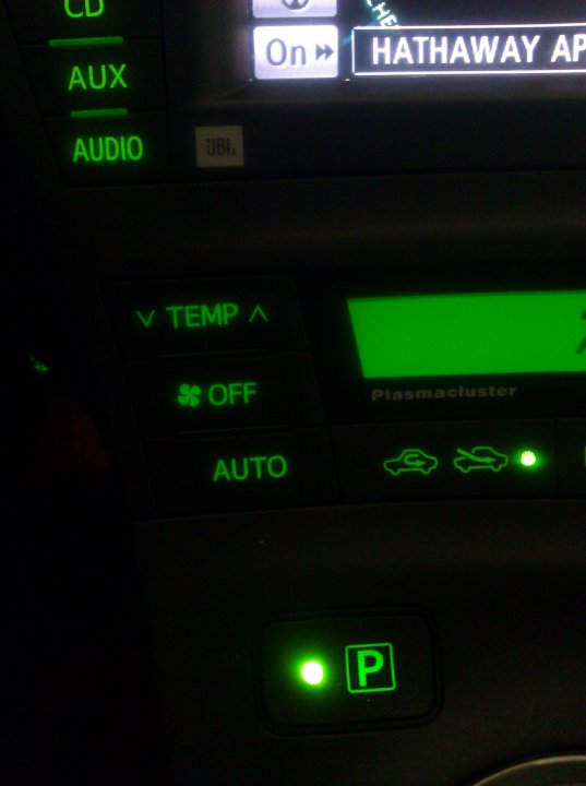

    OK, as my signature shows I own a 2012 PiP. I just went to the parking lot a try it.
    With the vehicle ON:
    All position lights off, the dimmer didn't affect it at all
    All position lights on, the dimmer attenuates the "P" symbol but not the "P" indicator dot.

    The first pic when it is dimmed.
