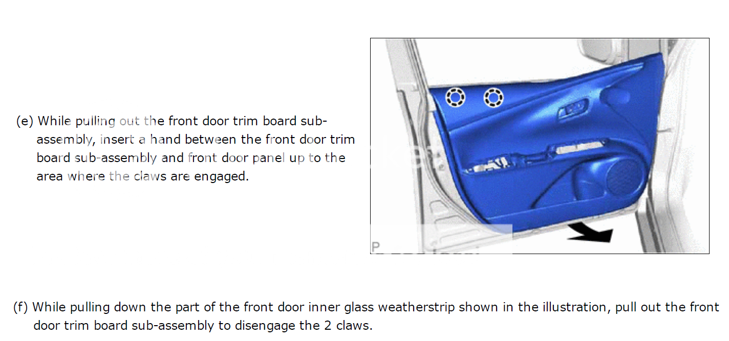

    When putting mine back on, I started at top--sort of "hook" onto the top rail, then snap on the clip near the mirror and go around/down from there.

    That what i am trying to do is from top but seem like is not hooking correctly. lol i spend few hrs now and i still cant get it hook the top rubber piece.

    Hmm..odd. The thing almost automatically popped in for me. This might help: there are evidently some "claws" towards the top rear of the panel. So you have to hook it on at an angle, and push it in. I didn't give it much thought but it did go back on.

    finally went in!!! i have to force it in the rubber/rail slot. This panel is pretty dang hard to put back compare to others cars. Thanks !!

    I had the same problem and realized that that clip was supposed to stay on the door. If you pop it out of the door panel and then try to put the panel back on it's a lot easier.
