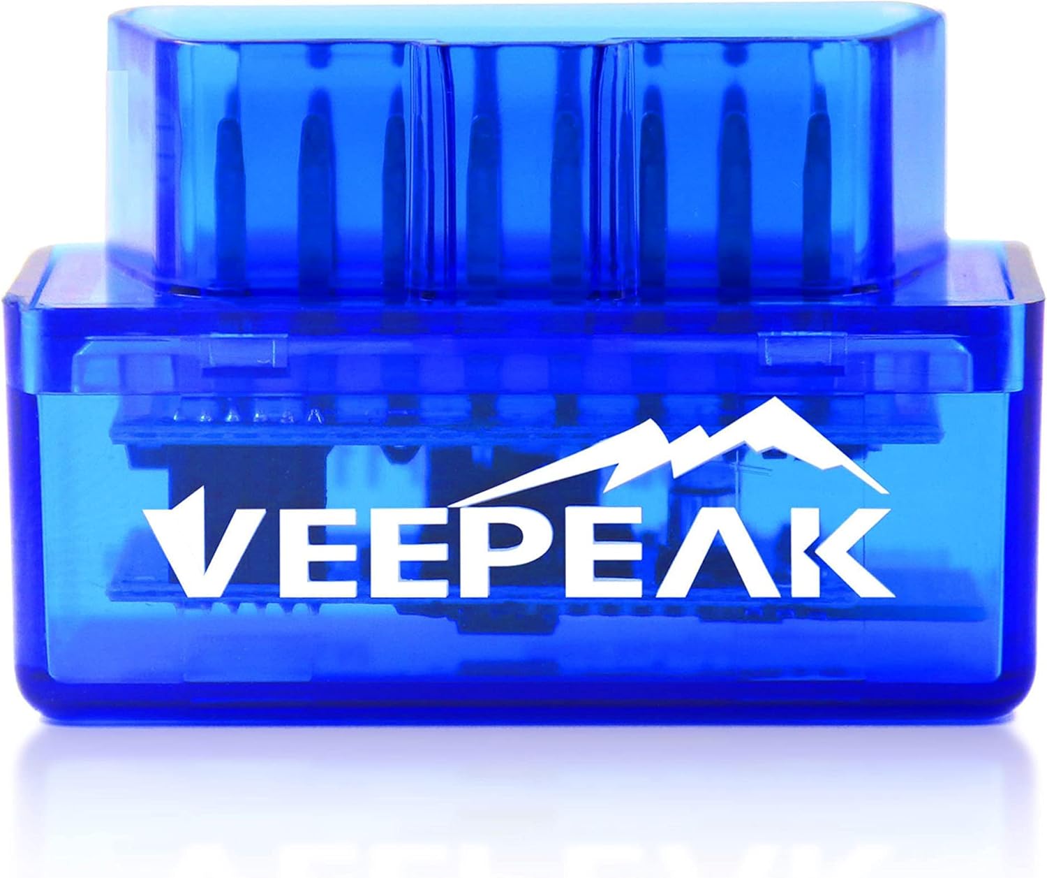

    I hate myself for misquoting . So it is not the overheating but I do get an occasional 'Check Hybrid System'. On the dashboard the battery charging animation shows it has 70% bars when charged. Funny thing it goes away if I turn off the car for a couple of hrs.But it will come back when I go hard on the Freeway.
    I have just gotten myself the Veepak OBD 2 scanner. And this should work with the Dr Prius app ? Let check them codes ?[​IMG]

    Dr Prius app is not the best free app to read trouble codes. Download the Car Scanner ELM OBD2 app to read the codes.
