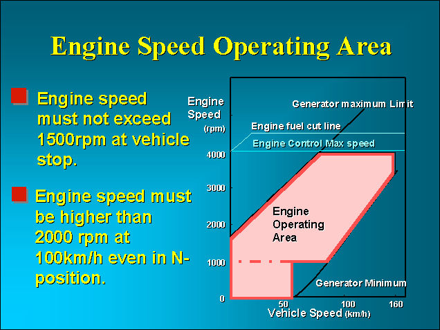

    FYI...
    An interesting chart. Please note that it's for NHW-10, the original Prius in 1997.
    Ken@Japan
  10. prius2go
    prius2go Member
    Aug 30, 2006
    312
    Thanks Ken :)
    I wonder if that 2000rpm limit is to ensure that the ICE has enough momentum that a combination of MG1 and MG2 is unable to force the ICE to run backwards. Do you know if there is a mechanical interlock to prevent that - or whether it doesnt matter with an atkinson cycle engine?

    <div class='quotetop'>QUOTE(prius2go @ Sep 3 2006, 08:29 AM) [snapback]313255[/snapback]</div>
    There is no interlock mechanism. We need a certain torque to drive the ICE, and nothing drives the ICE at that time.
