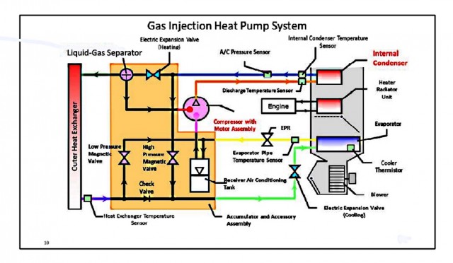

    I think there are actually 2 answers here, depending on whether you have a Prius or a Prius Prime. I believe the regular G4 Prius works pretty much as it has since at least G2. In the Prime however and since it works for extended periods (25 miles or so in NORMAL weather) it operates the Air Conditioner (Heat Pump) pretty much backwards. Picture you AC in when it is cooling the car. Low pressure coolant goes into the heat exchanger core inside the car and absorbs heat, it is pumped back out and the pumping further heats the coolant it then goes to another heat exchanger outside the car (usually in front of the engine's and/or inverter's radiators*) and heats up the outside air and cooling it back off. On the way back in it goes through a valve to reduce it's pressure making it ready once again to absorb heat from inside the car. All of that is like almost everyone else's AC works. (Most are driven by belts from the engine). In the Prime (and perhaps regular Prii) it is driven by an electric pump. Now what happens if you reverse this procedure? You heat the inside of the car and cool off the outside air. Now IF the engine is running, it will use the hot engine coolant to heat the car just like everyone is used to.
    *I peeked under the hood, but without removing some decorative (top) and aero covers (bottom) I can't EZly determine what's what. I believe I did locate the electric heat pump behind the right bumper and under the right fender.
    A "bit" more complex than that in your average car. :) This is just a schematic view. Alas I was unable to find an "in place" component view. I do have some pictures of the car with the front bumper (yes, all three parts) off. I will see if I find one or more that illuminate the situation.

  17. David Beale
    David Beale Senior Member
    Jul 24, 2006
    5,963
    1,989
    Edmonton Alberta
    The hot refrigerant comes from the pump - compress it to liquid, cool it, let it expand in the "other" rad. in the cabin, absorbing heat.
    You would probably be correct in "heat pump" operation though.
