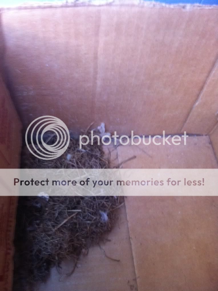

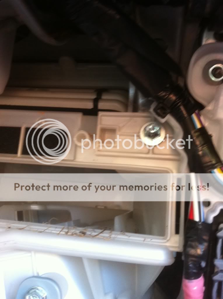

    Just bringing this one back up for timely reminder. I just got through cleaning out the Cabin Air filter area today due to one starting up a nest in there. We have had the car only 3-4 weeks?
    Was going somewhere last evening and the wife decided to get something from the glove box and noticed some debris in there. Looked like a sprinkling of fine grass clippings. No ball or nest like situation but made us suspicious. I pulled over and examined the area and even under the hood but nothing amiss. All clean and new. Nothing in this material was "car stuff". No insulation, carpet, filter material or plastics... just natural grass like stuff.
    So today I pull the glove box out and some of this debris around in there but no concentration of it. Everything around the area is intact. No chewing of any of the nice insulation or carpet or wires. So I then pull the filter out of its holder and presto! On top of the filter is a partially built nest. No car material in it. All brought in and all natural material except one, cigarette butt. One can only guess where that came from. Roadside or something. Looked like the amount of a nest any good mouse could accompish in a day even. Not completely packed but a good start. Had not chewed any of the filter or surrounding materials. Appears this loaded up the filter and air box area enough that some of it went out the blow by foam cover hole above the filter door. And that tipped us off.
    So I carefully hand removed the most of it, tried to vacuum out some of it but ended up by blowing it out with air pressure. Put in a new filter as I couldn't really get the old one cleaned up. The little pieces of grass were sort of embedded into the fiber too good.
    I then put out bait in the Carport area in a couple places, checked the other car that parks under there (found no signs) and moved the Prius to an uncovered place in the side driveway for a few days to give me some time to discourage the little bugger. I suspect he has already left and this happened about a week back but its only a guess. But its when the wife now says she noticed her defrosting was needing be done a little more often. That could just be weather and a red herring but no matter. But we will be watching regularly and baiting for a while. This has been a seasonal thing before when I have seen it. When they are in the nesting mood. Fall and Spring seems to be the time to watch out. And we are experiencing early spring like weather here. I am most worried about wiring though. They must go.
    I have dealt with rodents in cars before. One rat chewed up my kids car wires that went to the Coil overs so bad it would only run on two of the 4 cylinders and I have cleaned a few nests out of air breathers and such before. And Nut clusters on top of engines and such. So its not just Prius's I can tell ya that. But it could be they are very inviting... my theory there is that the low air dam all around the car makes it a lot easier to jump up there and access and also looks like good cover for a foraging mouse to run to. That's probably why it got the visit and the Mercury Grand Marquis next to it didn't.
    I would post pictures but I don't think I have hit my new member post allowance number yet.

    This area after removal of the loose ball of material but some of it is hanging on there as you can see. It was mostly just sitting right on top of the filter. Which allows some of it to come out over the top where you see that black Foam like material there. That material is soft and easy to push aside. Its probably there on purpose as a bypass if need be. That's probably why the material shows up in your glove box.
    The clump of grass material including a chewed up cigarette filter. I put a box under the area and carefully pulled it out almost intact into that. A little over fist size amount. But not hard packed.
