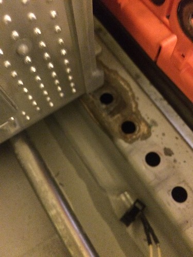

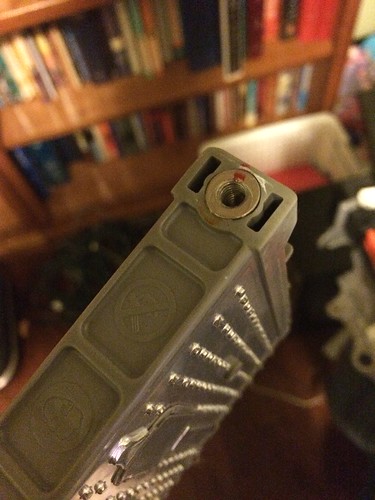

    [​IMG] Ok friends, work has let off for an afternoon to work on my car and i think i have something maybe, see attatched module, while it tests good there was a little moisture from the screw hole area and some coorosion (though no crack in the plastic that i could see) should i replace it, clean it and put it back? This looks like a leaky battery right?

    I would try cleaning and putting back first. This might be cell leakage, but you had a water leak so it could be that. Under constant voltage and high humidity metals can electromigrate. This could account for the stain and the corrosion. You've probably read the low success rate with module replacement, so go that route only if you have to.
