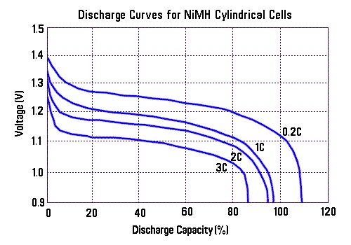

    JeffD, I apologise in advance for some people around being frustrated when I point out that your measurements are incorrect.
    But you've just not comparing apples with apples - i.e. capacity measured by you @ 0.1A with design capacity rated @ 1C. Those are and should be different.
    At the currents 60 times lower - you will be getting higher capacity than it actually is .
    That works equally applicable to other chemistries - to get an idea - have a look for example at the datasheet of UPS Lead Acid 7.2Ah - that capacity is not rated at 7.2 Amperes but at 0.35A.
    At about 4.3A discharge current brand new UPS battery according to the datasheet will not deliver more than 4.3Ah. I recently tested those for my industrial UPS (using our Analyser or course) and capacity is different at different loads as expected.
    http://jaycar.co.nz/products_uploaded/SB2486.pdf
    So with absence of sophisticated tools what prevents you from building simple (LM358 + Mosfet) constant current load, set it up at 6.5A (or at least in that range - 4 - 6 A) and measure time from fully charged to when it drops to 6 volts and publish your results?
    I bet you will not have your 6.5AH with that set up, will be much less.

    It is a fact that discharge rate and temperature affects battery capacity.
    Here is another very straightforward illustration via the fast google image search in relation to NiMH batteries (Prius NHW-10 and Honda have Cylindrical NiMH. This graph is not for Prius or Honda though) 1C- here means battery was discharged at it's rated current:
    If you still having difficulties to read, understand and comprehend that – do not worry – it could be dyslexia (not bad as many talented people have it) and if your GP confirms that – please stay away from Prius – as you may kill yourself by not being able to interpret the high voltage readings on the multimeter.:eek:
