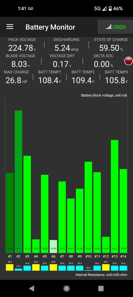

    I would definitely attest to properly torqued terminals. ;) In December, 5 days before a 90 mile trip for xmas I kept getting the triangle of death. Throughout the work week it kept getting more frequent. So I took a day off to replace a module I had purchased months in advance. Worked like a champ, for two months. The triangle came back. So I replaced another that had low readings. My pack only worked well for a week or two. The triangle came back. Had to keep clearing engine warnings while driving just to keep going.
    I did notice in the Dr. Prius app that the Internal Resistance was going way high, for all the blocks. It had reached 30 and even higher to turn to the color red. Even though the voltages seemed okay, after a while in the red I'd get the triangle again.
    So I found an old IN LB needle torque wrench in the my dads old toolbox, probably off by 2 or 3. I loosened what I had done previously and the wrench only went to around 15-20 IN LB. I had previously tightened all 60 nuts with a drill at a random torque number. They seemed fairly tight at the time.
    So I torqued all the nuts to about 55, ya maybe a bit over, but I've seen that post someone experimented and found over 100 is when it starts ripping things. So anyway, it's been great for 3 months so far, even on a 90 mile trip.
