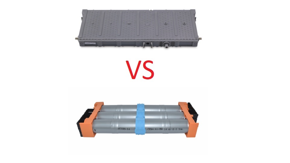

    highly appreciate if someone can explain the difference to me for both type battery replacement. Maybe some pros and cons will be helpful for me to decide. Prismatic VS Cylindrical.jpg

    Gen-1 Original Prismatic Battery
    • Youngest ones made in 2003, nearly 15 years ago.
    • Terminals are weak so heat can force H{2} and O{2} out gassing that dehydrates the cells
    • Narrow, air cooling space between plates makes cooling marginal
    • 6-cells per module
    New D Cell Battery Module (same as two Gen-1 modules)
    • Newly constructed, ~2016 and later, using robust modern cell construction
    • Higher surface area-to-volume for improved cooling
    • Plug compatible with Gen-1, Gen-2, and Gen-3 battery controller
    It is the most advanced, NiMH module construction that due to improved cooling is significantly improved over the prismatic cells. Best of all, takes advantage of non-proprietary "D" cells so in theory, cheaper than the original.

    Then why the h** Toyota is still using prismatic cells?
