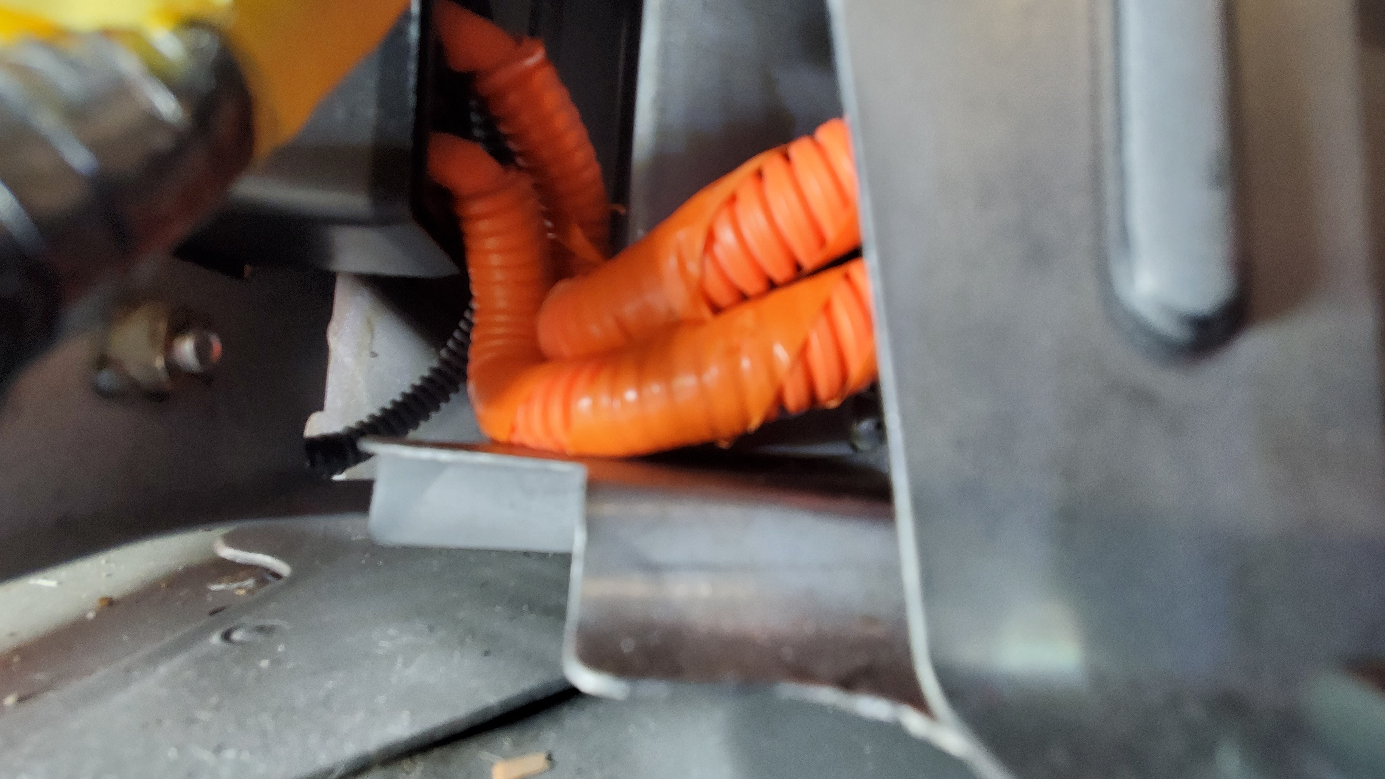

    Question for people who have installed this: What did you end up doing with the battery disconnect cables? I was able to get them connected at 90 degress so they fit in the plastic cover, but in order to keep the cables inside the ECU area and away from sharp edges I had to bend them at some pretty severe angles, and the more I think about it the less I like it. I'm probably going to go back in and move things around, maybe modifying the safety cover to allow them to come out the top. Is this what other people are doing or did you find a better way to route the cables?

    They should route normally. Do you have a photo?
    They don't bend so easily but some very mild warm air to heat them up a tad helps wonders with routing. Never too hot to touch, just generally warm

    I was able to get them bent, but I'm worried about how much they're bent. They basically make a 90 degree bend as soon as they come out of the connector, which seems like too much. The problem is that if I don't wedge them in place like that then they rest of the sharp edges of the case which also seems like a bad idea.[​IMG]

    Prius Chat user @edthefox5 has a nice post with very good pictures on how he installed and routed those cables. Worth a look It's this thread post #822

    It's not ideal, but copper does bend. Some cables are shorter than others but yours seem to have enough slack to route out straight and wrap around? Or on top?
    Yes he does. There are a few good posts. Generally routing them out straight is the best option. Some of them are a bit longer than usual and some are a bit short. If too long, you should get extra in the ecu area. If too short that's where you see some strain. It's just part of the tolerances of the OEM cable as that's one we do not replace unfortunately

    Yeah, so ed left the slack out by the battery instead of by the ECU. I think that was the method that would require modifying the safety covers though since they won't fit properly over that routing.
    I initially had them come out of the connector straight and loop around, but then they rubbed on the metal casing and that seems really dangerous. If it wears through the sheathing on the cable it could energize the entire case, right? Which is a problem since you need to reach in there to remove the safety plug.
    I'm kind of leaning toward padding the case with some of the packing foam. That should let me route the wires less severely and keep them from rubbing on anything sharp. I might even be able to do that without tearing apart the car again since I have access to that area with the bin out (I will, of course, remove the safety plug and wait ten minutes before sticking my hands in there).

    Bit easier to see from this angle, but the wire has thick insulation and then a plastic sheath as well. It is meant to go in and around the metal casing. The internals of the battery vibrate mostly together. Meaning the wire vs metal wont be moving across themselves as much as you might think.
    I wouldn't add foam as that is just a loose piece unless you can sandwich it somehow. But again, none of that is needed, it is designed to be that way.

    @nemebean It's pretty easy (and cheap) to get some fuel tubing and slitting it down one side and slipping it over a sharp sheet metal edge if you're worried about chaffing through the cable. I did this on mine in one area of the case the case just to satisfy my OCD, but it likely wasn't really needed. I don't actually recall the size since it was just some tubing I had available in the garage, but I think it was probably 3/8"
