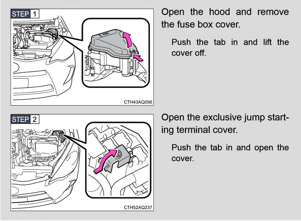

    Jump points are under the hood in the UBEC near the left (drivers) side strut tower.
    This information is in the manual too :eek:

    Here's the location info.

    Note*** Not all 2013s have this. It was an early addition, I believe in February or March. Most January 2013s don't have these jump points.

    But the 2014s certainly do, and I would expect the 2015s also do.
    So, to remove all speculation, 2014s and 2015s can use the special jumper location provided within the engine compartment: black cable to the frame, red cable to the special jumper location.
    Also 2012s to midyear 2013s must use the old battery jumping technique, whereas late 2013s may use the 2014 and later jumping technique.
    However, all may use the earlier jumping technique, in a pinch.
