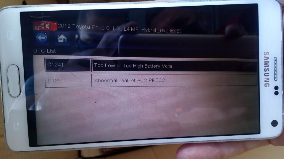

    My 2012 Prius C lost brakes about 3 days ago, the 4 brake lights were on in the dash, and the brake accumulator was running every 3 to 4 seconds, until it stopped running and brakes were no more. I think that the brake booster was leaking internally losing pressure, making the accumulator to run constantly to keep up the pressure until the accumulator motor burnt, now i have to pieces to replace. The brake accumulator the dealer said is about $905, and the brake booster about $1,398 + 500 of labor.
    I don't know what to do now, i got this vehicle for $6,500 and such repair cost is kind of close to half of what i paid for it, and i don't have good income, i can't really sell the car either, used parts could help but if these 2 parts have a defect [they probably do] which Toyota fixed later on newer models, buying used means that i will have to remove the inverter, wipers and more to dig all the way down again to replace them once they start dying again.

  8. ChapmanF
    28,714
    19,011
    If you look closely at that fortune cookie, it says "Abnormal Leak of ACC PRESS", and of course 'actuator' does not have two 'C's, so you know it is talking about the ACCumulator.
    On the other hand, when accumulator pressure does not hold, the fluid can be escaping through paths either in the accumulator or the actuator, so the code's fortune cookie just doesn't really give you any help deciding which component has the problem. If you are a gambling sort, there are more valves inside the actuator, so that might be your first bet.
    The part names trip people up all the time anyway. Which of these did you actually replace? (This illustration came from Gen 3 liftback docs, but I think the c is similar.)
    The thing on top is also called the actuator. And also the master cylinder. And also the Skid ECU.
    The thing on the bottom is the "accumulator" or the "booster pump". It isn't the "booster"; that's again one of the names for the thing on top.

    I see, i stand corrected then, and the one i bought today to replace was the brake accumulator, since that's what the dealer told me based on the code.

    I see, well, when the brake lights came on, i opened the hood and took a look at the brake fluid reservoir, when the pump turned on to pressurize the system the level went down, but as son as the pump turned off the fluid level went back up again in 3 to 4 seconds, so the pump had to turn on again. It lasted like that for 2 and a half months i think, until the pump did not turned on again and i lost brakes completely.
    And yeah i have been confusing the names for a long time, but i think i understand it now. The piece with the 2 cylinders, the smaller cylinder is the electric pump, and the bigger one is the accumulator? and the other piece is the brake booster? the one in the image above, ''brake booster assembly''.
    Even though i tried to search for these common problems like the gen 3 Prius had in the brakes, but in the Prius C, it seems like the Prius C barely suffers from such thing, maybe i bought a lemon, one of the few that got a bad accumulator. I think i only found 1 person complaining about the Prius C brakes.

    Right. The names are confusing because each assembly has multiple things in it, and even the Toyota literature can call them by different names. The thing on the bottom with two cylinders has the "booster pump" and the "accumulator" and it can be called both of those things, but not the "booster" (that's in the thing on top).
    The thing on top has the "master cylinder" and "booster" and "actuator" and "skid ECU" and can be called any of those things depending on where you are in the manual, but again the "booster" is not the "booster pump" (which is in the bottom thing). And the "actuator" and "accumulator" are easy to confuse because of the ac-, but one is in the top thing and the other isn't.
