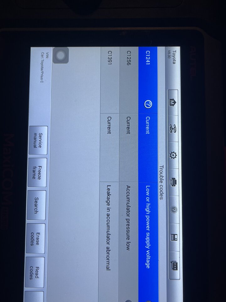

    Was pulling out of car park when I noticed abs,traction control, brake light n warning light came up, it went off but came back up as I was driving that when I felt the difference in the brakes it sank more n felt like I was loosing pressure until the pedal bottom out, the brake assembly made more noise than usual, the pulse I felt when I started the vehicle from the brake pedal it not present once the lights or on but when off I feel it,note before I bought this the brake assembly was replaced with a used on could it failed already or could it be the master cylinder need changing or entire assembly again

    Check the fluid level for the brakes... Also, how often do you hear the brake pump running? What happens when you pump up the brakes?

    12v battery fully charged?
