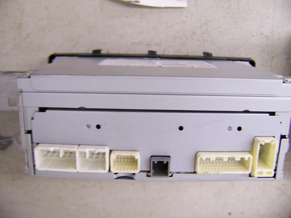

    Here's the photo:

    do you know what the connection to the usb/aux ports look like?

    The grey one on the center is the OEM USB/3.5 jack audio plug.
    Go to page 7 on this thread and you will get more info on this.
