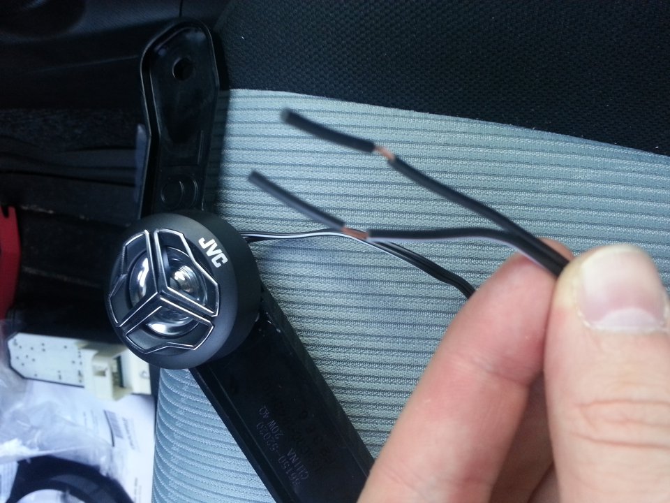

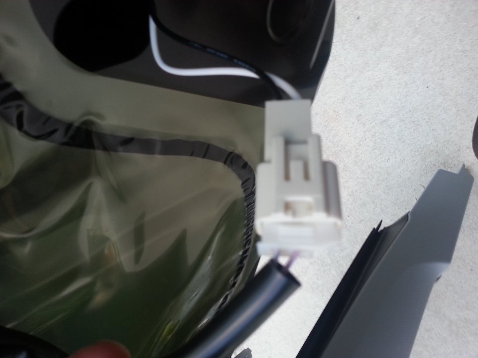

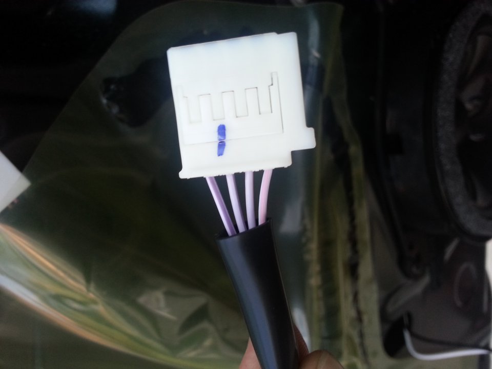

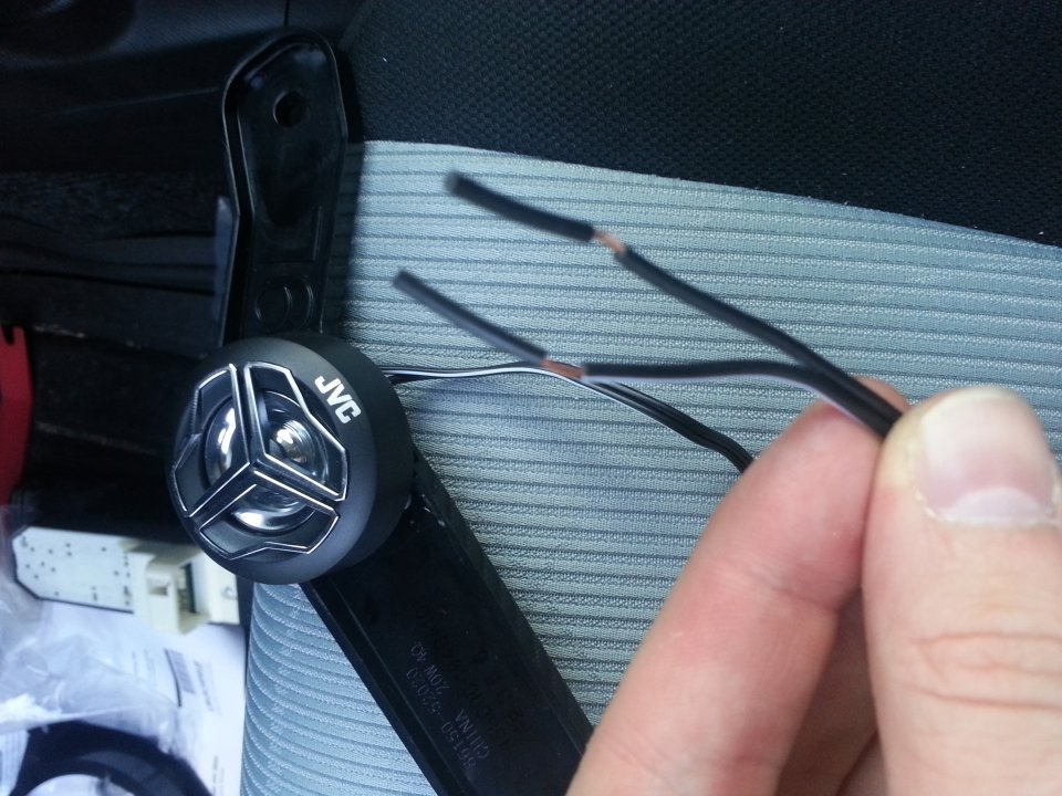

    I am upgrading my stereo system now and am working on replacing the speakers. I have a question about the tweeters though. The woofer has an adapter so that was plug and go but there is no adapter for the tweeter. Now the problem is the plug that went into the original tweeter has 4 wires going into it 2 purple and white wires and 2 pink and white wires. the new tweeter has 2 wires the positive and negative wires. I don't want to cut the 4 wires to splice them to the 2 wires on the new tweeter and it not work. Is there an adapter for the tweeter I can plug and go? Or has anyone replaced their tweeters and wired them so you can tell me what to do? Below are pictures of what I'm talking about.
    20130730_193737.jpg This is the woofer plug all plugged in
    This is the plug that was plugged into the original tweeter which is now destroyed...ooops
    These are the 2 wires that I somehow need to wire into the 4 wires for the tweeter or find an adapter for it to plug and go.
    Any help would be greatly appreciated!

    Did the new speakers cone with a crossover of some sort that should provide the hookups

    I haven't looked in a Prius c door lately, but IIRC the c has both audio signals for the tweeter and woofer (4 wires) going to the tweeter first, then the 2 wires for the woofer go from the tweeter to the woofer

    This is correct. 2 of the wires are coming from the head unit into the tweeter, and the other two are basically pig-tailed off those, to connect to the woofer.
    Just find the combination of the two wires that work, and make sure you use consistent colors on all speaker connections, to keep them in phase.

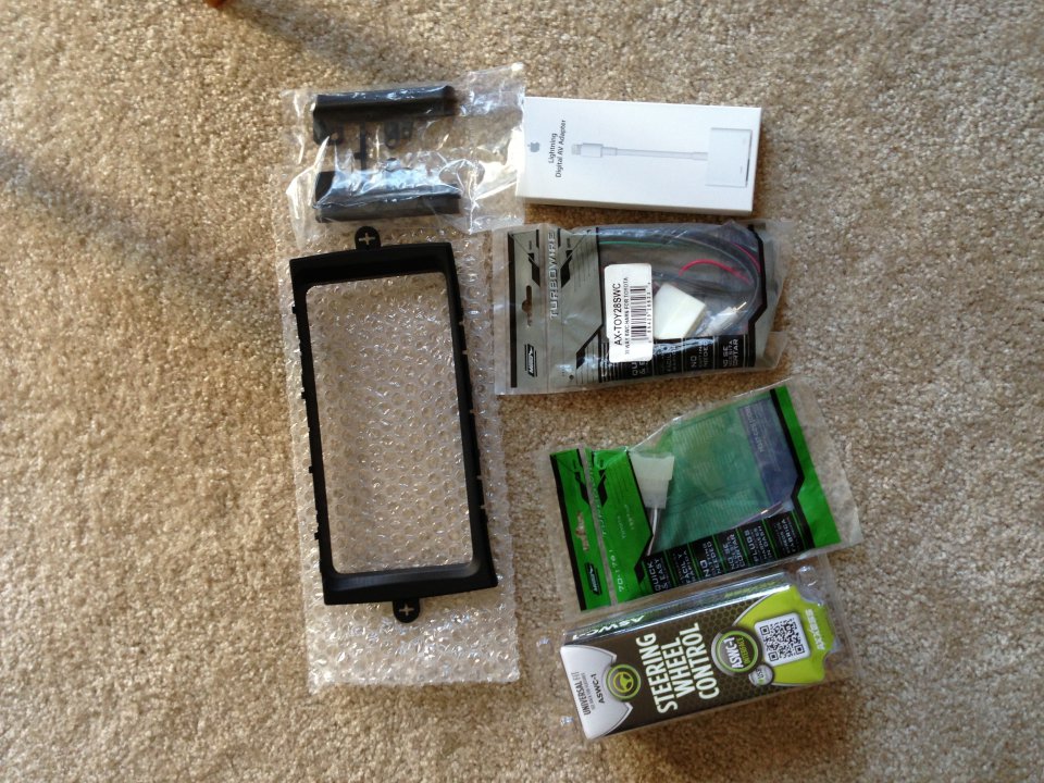

    Got all the needed goodies in. Can't wait to get the head unit in next week.

    So I have the AX-TOY28SWC, Metra 70-1761, Metra 40-LX11, and the ASWC-1. How do I plug all this together?
    I'm usually familiar with the 70-1761 into the aftermarket harness. But where does the AX-TOY28SWC and the ASWC-1 fit in?
