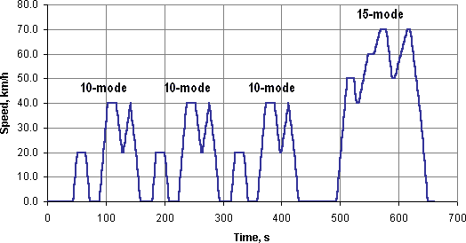

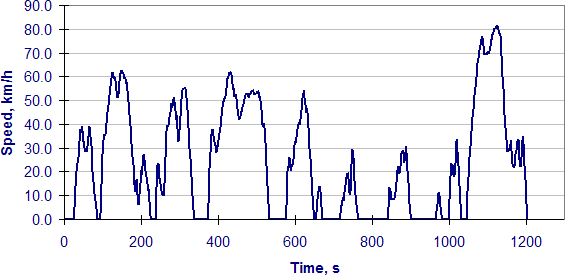

    The problem with that comment is that, under the 10-15 cycle (lower speed), the fuel efficiency gap is lower between Prius and Prius C.
    Prius C loves the more aggressive JC08 cycle due to 500 lbs lower weight. EPA cycle is even more aggressive so I would expect the gap to get wider.
    JC08:
    10-15 Mode:

    FYI,
    "10-15 mode" test is done after engine warming-up.
    "JC08 mode" test is done under both cold and warm engine, then the data is calculated by 25% cold engine and 75% warm engine.
