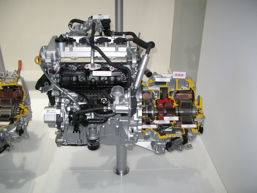

    Definately the rock solid NiMh. 8 less modules than the regular Prius - about 30% less.

    Pretty electric water pump :)
    I presume the spikes are for cooling

    What's amazing about Prius c is the weight. From the Aqua spec, it is going to be lighter than the comparable non-hybrids.
    Only iQ will weight less. Prius c weight may tie with Fiat 500.

    It doesn't look like it will fit. Just look at the oil dipstick. It doesn't look like there is much room left.

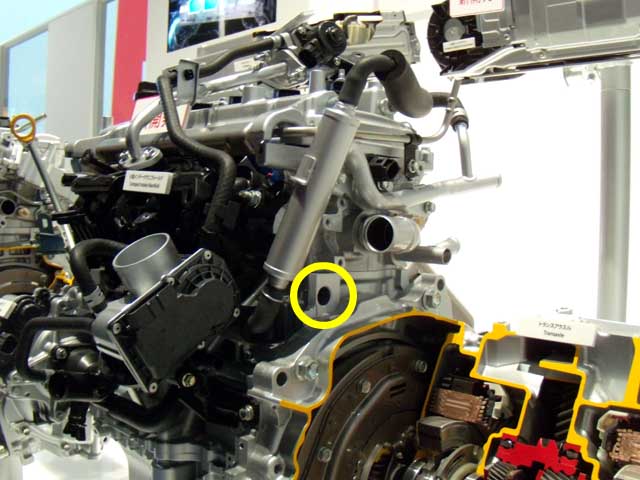

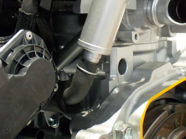

    FYI,
    re: engine block heater hole
    We know Aqua (Prius c) uses the same 1NZ-FXE engine as Gen2.
    However, I found an interesting point at the Tokyo Motor Show.
    The Aqua (Prius c) engine block heater hole is now on the intake side than the exhaust side on Gen2.
    So, the 1NZ-FXE on the Aqua (Prius c) uses newly developed engine block.
    Ken@Japan
