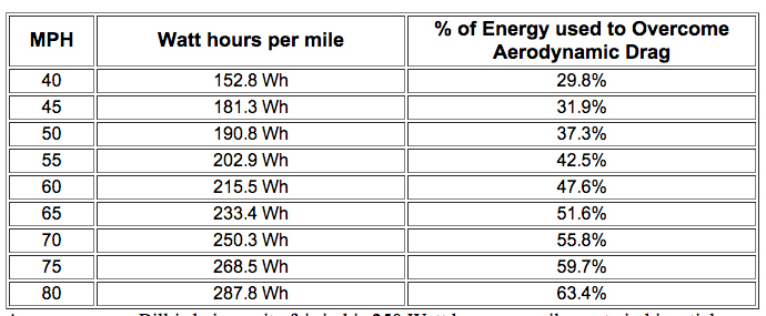

    This table is by Wayne Brown using a G2 Prius:
    You will have to play some arithmetic games to figure out the 'C'.
    E.g.,
    Air friction
    @40 mph: 152.8 - 107.26 = 45.54 Wh/mile
    @ 70 mph: 250.3 - 110.6 = 139.7 Wh/mile
    Difference: 139.7 - 45.54 = 94.16 Wh/mile
    If the Cd increases from 0.25 to 0.28,
    @40 mph: (45.54)(28/25) = 51 Wh/mile
    @70 mph: (139.7)(25/25) = 156.46
    Combine numbers, and we get total friction @70 mph in a G2 Prius with a 0.28 Cd = 110.6+156.46 = 267.06
    The total Wh/mile in a less aero G2 Prius increases by 267.06/250.3 = 6.7%.
    Call it 3 - 3.5 mpg. As an aside, this is why AG quite correctly points out that a large fraction (perhaps the majority) of the difference between a Prius and a mediocre Ford hybrid are the aero differences.
    Above is the laborious and pedantic approach. I'm usually much lazier, and just mentally calculate the following: 28 is about 12% more than 25 (the increase in Cd.)
    Since air friction accounts for some 50 - 60% of total friction at usual highway speeds, the increased Cd adds 6 - 7% more energy consumption.

    I put the figures from the Wayne Brown chart into a spreadsheet, extracted the aerodynamic drag portion, and did a curve fit. R-squared is unity when fitting to a polynomial of N=2, or quadratic. When fitting to an exponential curve, r-squared is no longer unity. So his figures are polynomial, not exponential.
    Computing from his chart, aerodynamic drag alone (mechanical drag excluded) is 2.4 horsepower at 40 mph, and 19.5 hp at 80 mph.
    Extrapolating out to 150 mph, the quadratic curve fit reads 129 hp. The exponential fit reads 430 hp.
    Continuing to Mach 1, set to 760 mph for this exercise, I get about 17,000 hp for quadratic, and between 2 and 3 trillion hp for exponential. The former is hot, but the later is a meteoric fireball. The former seems realistic for jet fighters, the later does not.

    hmm, so one would expect an 8x difference. 2.4 * 8 = 19.2. Pretty close
    I find it easier to just leave the units in Wh/mile:
    At 40 mph, 45.5344 Wh/mile aero energy reqs
    At 80 mph, 182.4652 Wh/mile aero energy reqs
    182.4652/45.5344 = 4.007194561
    Remarkably close to expected 4x

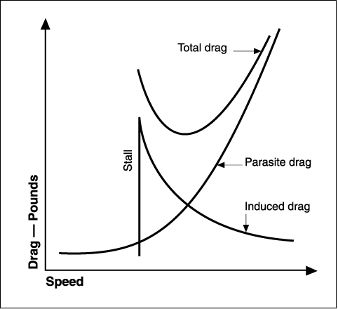

    But there will come a point on the chat that the drag curve becomes nearly vertical and the 8x difference will not be accurate.
  16. usnavystgc
    Jul 29, 2011
    3,159
    990
    Tucson, AZ
    1) I'm not a math whiz (at all). It does seem realistic to Mach 1 but, there will eventually become a point (not sure what speed) of near vertical drag curve drag curve.jpg .
    When that happens will the polynomial or quadratic still work?

    A quadratic is just one of the simplest members the polynomial family. Did you mean to ask about exponential?
    As far as mathematical functions are concerned, 'near vertical' is just a matter of perspective or scale. All the functions mentioned here will get there, but an exponential function gets there much quicker and much steeper. In this case, the exponential curve will be prohibitively steep at a speed where a B52 or large commercial airliner could, in reality, still carry the car under its wing without leaving the fireball trail required by an exponential extrapolation of Wayne's chart.
    Real air drag is probably somewhat more complicated than a simple quadratic function at high speeds, especially when crossing through mach 1. But it is clearly not an exponential function.
