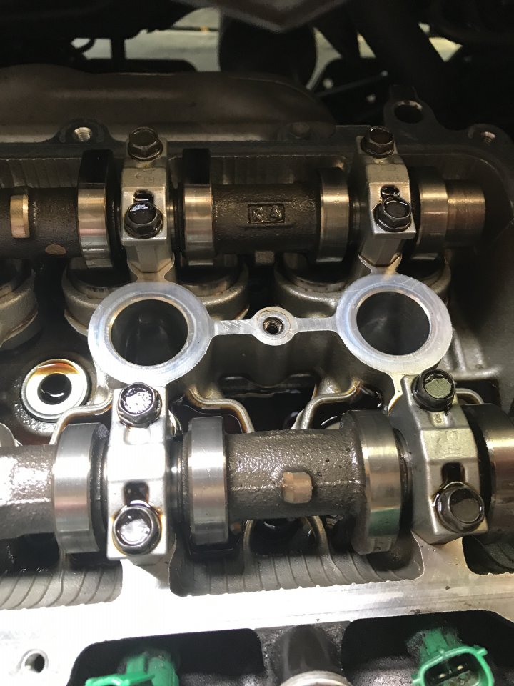

  7. ChapmanF
    28,735
    19,033
    From edthefox5's valve-train photos thread, still looks like the same select-fit solid lifter system I knew and didn't love in my Gen 1....
