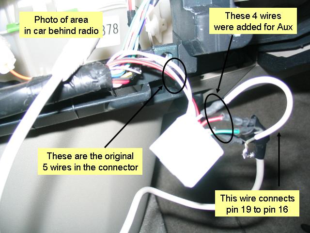

    The USB works with this but not the AUX. I was going to go through the mess of wires and figure out which ones do this, but I really don't use the Aux that much and needed it for my iPod to work with the Kenwood cable.

    Ok, thanks. Hey do you know what are the 4 cables (color better) from the mic in the 28 pin and what cable does what??

    Do you know how to get the jumper cable if you dont have one? I upgrades to a C3 radio/nav unit and have everything working minus the CAR and APPS and one other thing im assuming because Im missing this wiring to provide power to the components?

    you need to add the 3 wire to the radio harness like this

    Adding a Vehicle speed wire.

    Thank you for the help....I'm a little uncertain if I can do the mods without totally messing up my electronics....but ill review it and thanks so much for the detailed pictures. The alarm wire you mentioned? is this just a wire that is unused in the prius C or a wire you had to splice with?
