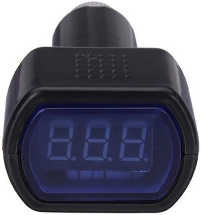

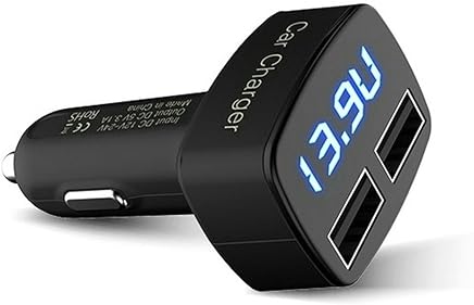

    Does mealsonwheels have (or is able to borrow) a voltmeter to check the 12V battery condition? Even a cheapie like these, plugging in to the 12V power outlet, can provide a lot of information:
    [​IMG][​IMG]
    The one I put in my spouse's car pre-dates the now-common USB-outlet-combo style. She used it to help me diagnose an intermittent, sporadic charging system failure. But in ignition Accessory mode (not Ready), it will also betray many (not all) failing 12V batteries.
    Replacing a failing 12V battery would be far cheaper than replacing a whole car. And at this age, if it has never been replaced, the factory battery is getting long in the tooth.

    That's what I thought, too! I know next to nothing about technicalities, but I do know that everyone is trying to push off the responsibility onto someone else. I'll go ahead and get the cheapie voltmeter as well as taking up the Toyota dealership's new offer to diagnose the issue for free.
    And then, I'll make a new post! Didn't mean to hijack I am so lost.
