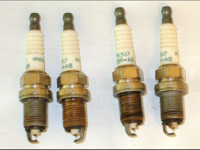

    I passed the 58,000 mile mark and thought I'd take a look at my spark plugs. They did not look bad at all but in checking the DENSO spark plug site:
    Frequently Asked Questions: DENSO Iridium
    I discovered they recommend replacement after 30,000.

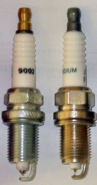

    Only iridium plugs available locally were Champion 9002. I got some and began the change. After removing the first plug, I noticed a difference between the OEM DENSO 3485 (also listed as FK16R-A8) and the Champion. I liked the precision look of the DENSO compared to the CHAMPION:
    So ordered some from Rock Auto and returned the Champs.

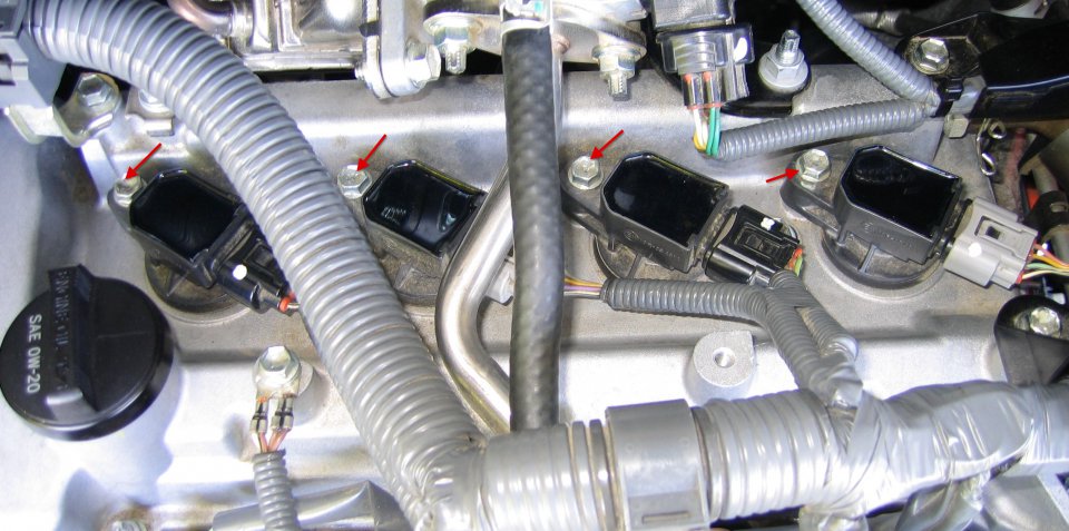

    To make the replacements first undo the 10 mm bolts holding down the coil sleeves:

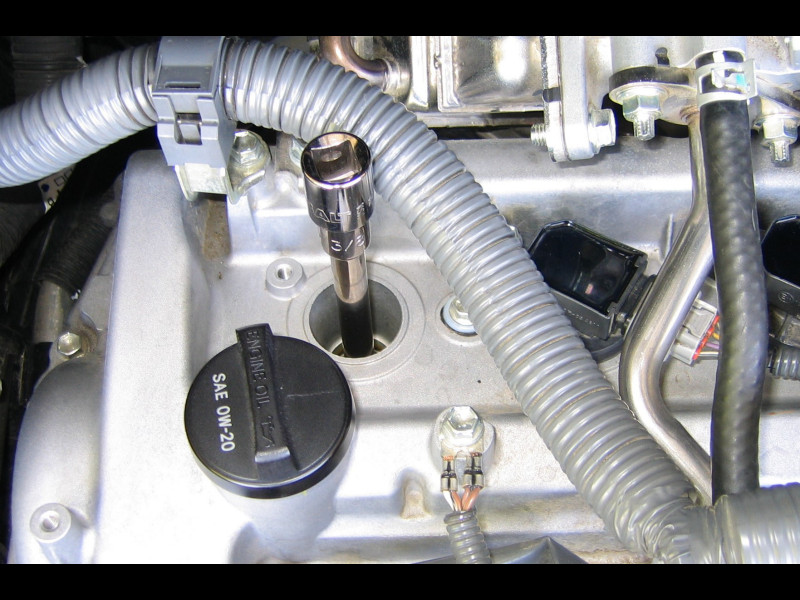

    Then using a 5/8 inch spark plug socket, remove the plug. You will need an extension to reach:
    Unscrew. I vacuumed the opening beforehand just to make sure nothing had dropped into it. Then place the new plug into the socket and hand tighten. DENSO has torque recommendations:

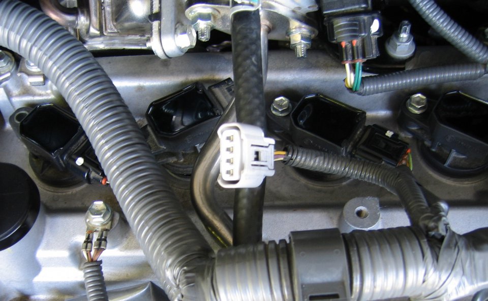

    I forgot to mention a couple of things. The plugs are 14 mm flat seat. And one has to unplug the clip from one of the coil sleeves in order to pull it up. you will have to turn it a bit to get it past the tubing.

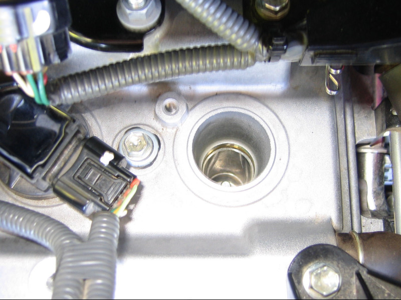

    Was the inside of the plug hole clean and dry?
  4. ufourya
    ufourya We the People
    Aug 20, 2008
    1,258
    336
    42
    Yup.

    I don't think I've ever seen a Japanese plug hole without grit and oil. Sometimes LOTS of oil. Granted, my experience with non-American cars is limited, but I would be overwhelmed to find a hole clean, dry, and shiny. I'd have to just look at it for ten minutes or so before I even grab a wrench.

    Ha ha. I was amazed that the old plugs look as good as they do. I wonder what I'm doing wrong.

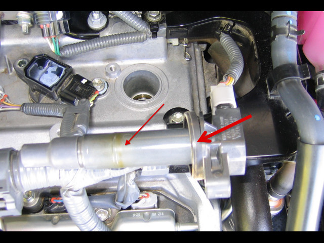

  14. ufourya
    Aug 20, 2008
    1,258
    336
    42
    The sleeve with the rubber gasket (large arrow) apparently does an excellent job protecting the well. I have not pressure washed or even hosed down the engine compartment. So I don't know how the well IMG_3677 (2).JPG could get too dirty or wet. Since we drive hybrids, the mileage on the ODO will not represent the mileage on the plugs. Toyota says 100k and Denso says 30k. I frankly think the ones replaced appear to have many more miles in them, but the new ones were begging to be installed. I learned something. Hope this thread will be helpful to the inquisitive.
