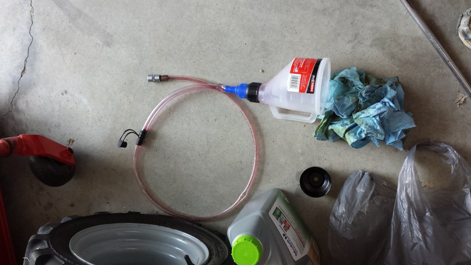

    Gear oil funnel with long hose (I got the one pictured at walmart for $5, added a piece of hose I had).

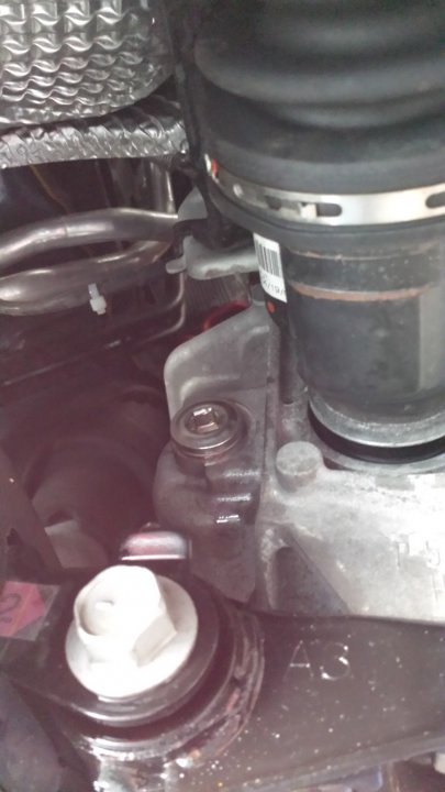

    Before draining the tranny, be sure you can bust the fill plug loose (juuuuust in case!) The fill plug is on the back side of the tranny, near the rear motor mount, near where the passenger axle enters the tranny (you'll be looking towards the drivers tire to see it from the passenger side).

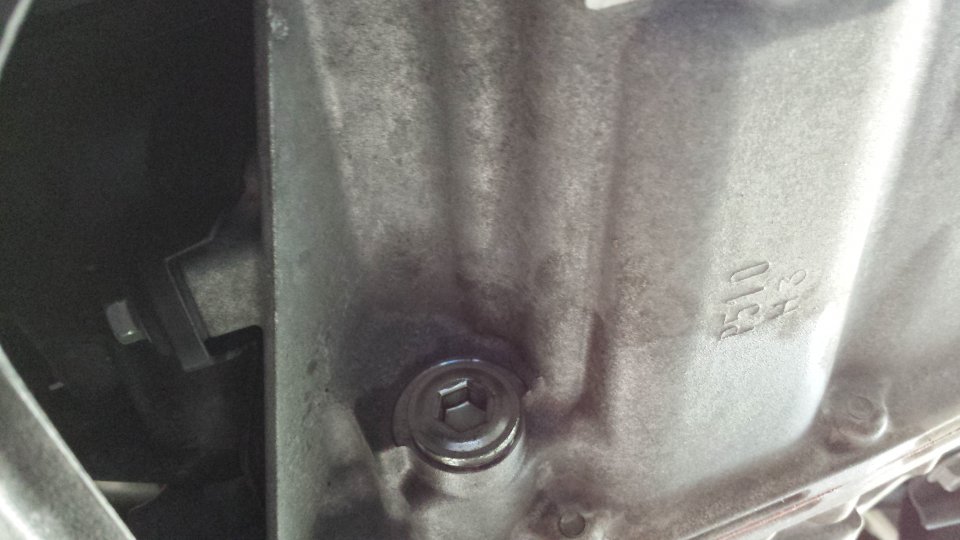

    Started the draining process, look for the drain plug on the transmission, you'll be looking towards the passenger side and see the 10mm socket low on the front side of the tranny.

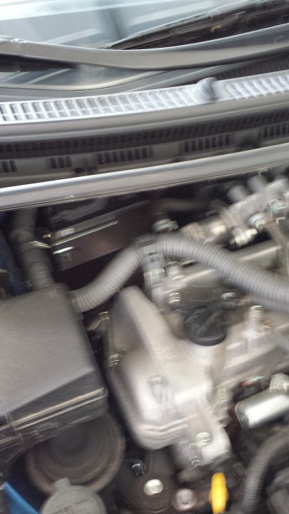

    Fill back up using the fill port in the back of the tranny, note that I had my funnel on the passenger side, behind the engine near where the oil fill cap is (sorry for the blurry cam). The funnel + hose + my additional drain hose was perfect length to run down to the drain hole. You also want your drain pan under this fill port for when it starts to run out.

    1. Walmart fill funnel w/hose (plus some hose I had laying around added to it).
    Blurry cam - back corner of engine near firewall where I had the funnel sitting, ran the hose down the back of the firewall to the fill port.
    Drain plug - front of tranny - looking towards the passenger wheel.
    20140803_110702.jpg Fill plug - back of tranny, above rear motor mount - looking towards the driver's wheel.

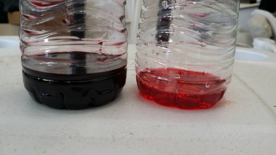

    Just did the fluid change at 55k miles. Fluid was dark and nowhere near the cherry red new fluid. I think it's a good idea to change it. Couldn't hurt. Took me same amount of time as doing a regular oil change.

    35k miles old vs new. Can't get pix to load.

  19. Invisibleman
    Invisibleman Junior Member
    Jul 7, 2014
    Vista, CA
    2013 Prius c
    Yeah, I posted the bottles, but somehow that pot showed up. Don't know where it came from, so I deleted it and reposted again.
