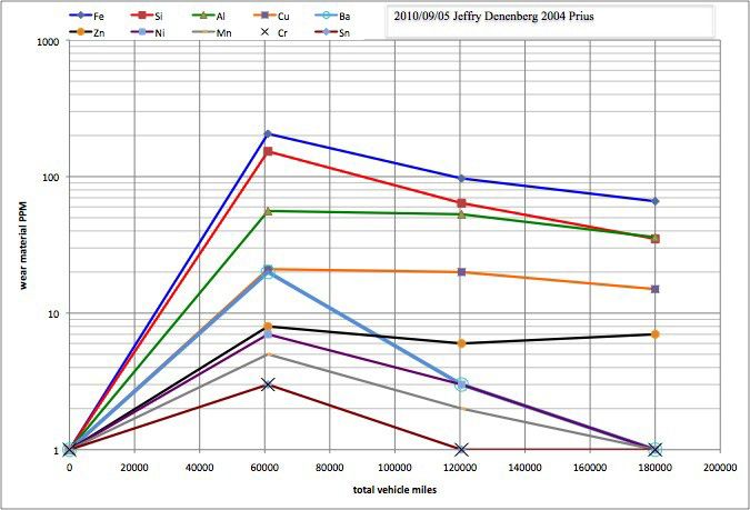

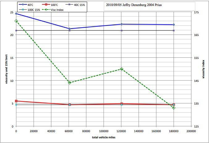

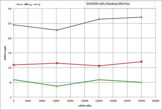

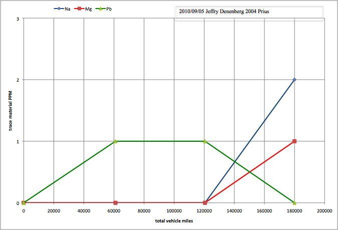

    The debate on when to get the transaxle changed should be driven by hard clinical data (oil analysis). It doesn't get better than this.
    Nope. Professor Jeffrey Denenberg's oil analysis says otherwise. Look at the second graph (Wear Material vs Miles). Imagine how much more wear materials would be showing up at the first transaxle oil change of 100,000 miles vs the 60,000 mile mark on the graph? FYI, my transaxle failed at 91,000 miles, no fluid drain/fill either. If someone doesn't keep their car that long, transaxle problems will likely be inherited by the second or third owner.

    Conor, Frodoz is right, based on Professor Denenberg's oil analysis. The Professor concludes 30,000 miles for the first change. 60,000 miles for a second change, more or less. Then subsequent changes can see a longer interval. All to reduce wear.
