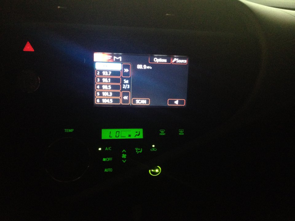

Hello jonpk, One question, I bought and install the same radio you have, the back lit buttons you mention are the ones in touch screen... did the power, audio, tracks, setup, etc buttons also have orange back lit? since in my radio those button do not have back lit, or maybe the radio i received is broken... don't know, please confirm me this. Thanks.
the backlit on those buttons will only come on with headlights AND if you turn up the brightness of your car's interior dash lights (on the knob to the right of the steering wheel that controls the brightness of dash lights)...if the knob is turned all the way down (lowest brightness of dash with headlights) then you won't get any backlit and yes those backlit are orange/lava colored in nature (it is probably green for those who have the highlander radio instead)
yes the highlander radio has green backlit buttons. They only turn on with the headlights and if your dash light dial are high enough.

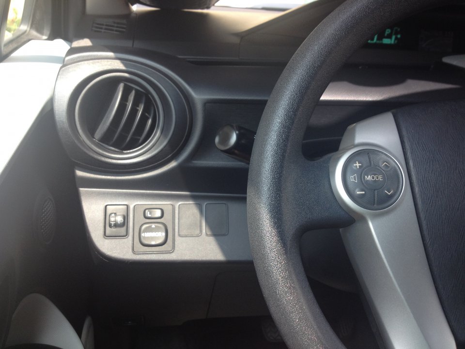

I dont have the dash light dimmer in my car !! I guess I'll have to order one switch. When I turn on the headlights the radios button won't turn on and the you can't see them in the night.
It's dimmer that controls the "range angle" of the headlights, the part I need is the Light Rheostat 8411942020, I hope this can connect to the main electrical system.

hmmm interesting that your new radio doesn't work. i honestly dont see why the new radio lights wont work but the old radio, which uses the same connections, works.
It's just the nature of the beast that the stock radio is programmed (or w/e) so that backlit comes on when headlights come on (no matter the position of the dash brightness dial), while the corolla/highlander radio may not be programmed in that way for the C... But it's just weird that your country doesn't require a dash brightness dial for vehicle (s)
