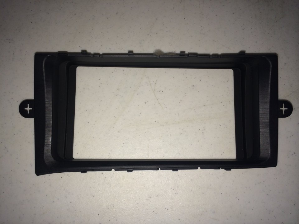

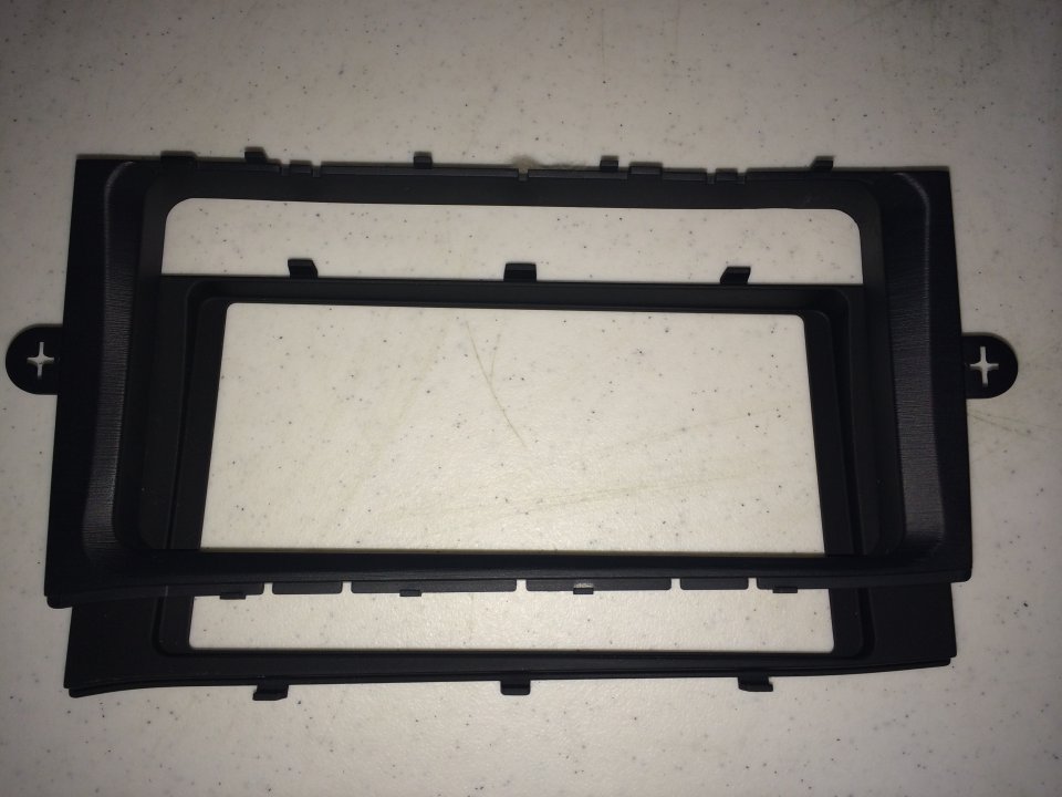

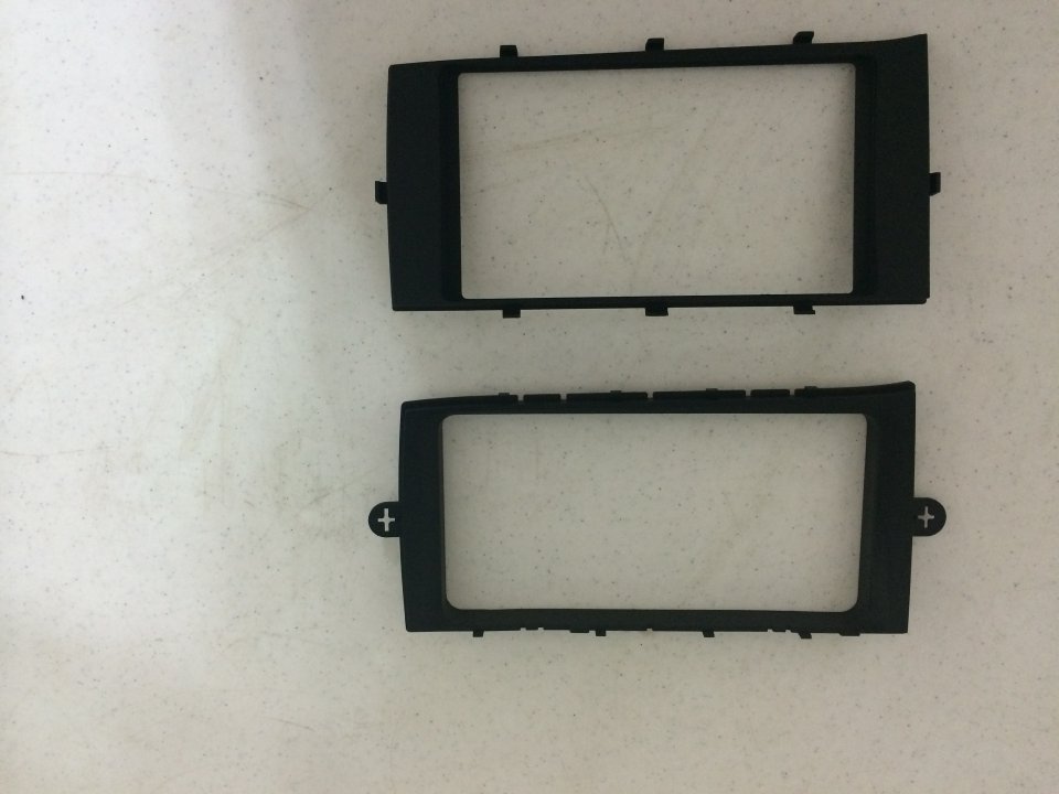

    Let clarify it with the following pics:
    1. JT Torres kit shows bottom, Metra Kit shows top, visually seems that JT Torres are wider than Metra:
    2. Placing JT Torres on top of Metra you will see the wide diferrence between both.
    You see that when JT Torres inside opening edge finish, the Metra one are still visible on the bottom.
    3. Separate a little bit still looks like the photo above:
    Conclusion:
    • JT Torres kit - TOYOTA OEM RADIOS (Highlander, Corolla, Scion, Rav4), plus with a inserts came with the kit you can use it for AFTERMARKET RADIOS too.
    • Metra and Scosche kit - AFTERMARKET RADIOS ONLY (Pioneeer, JVC, Kenwood, Sony, etc.), no TOYOTA OEM RADIOS.
    I hope this clarify anything.
