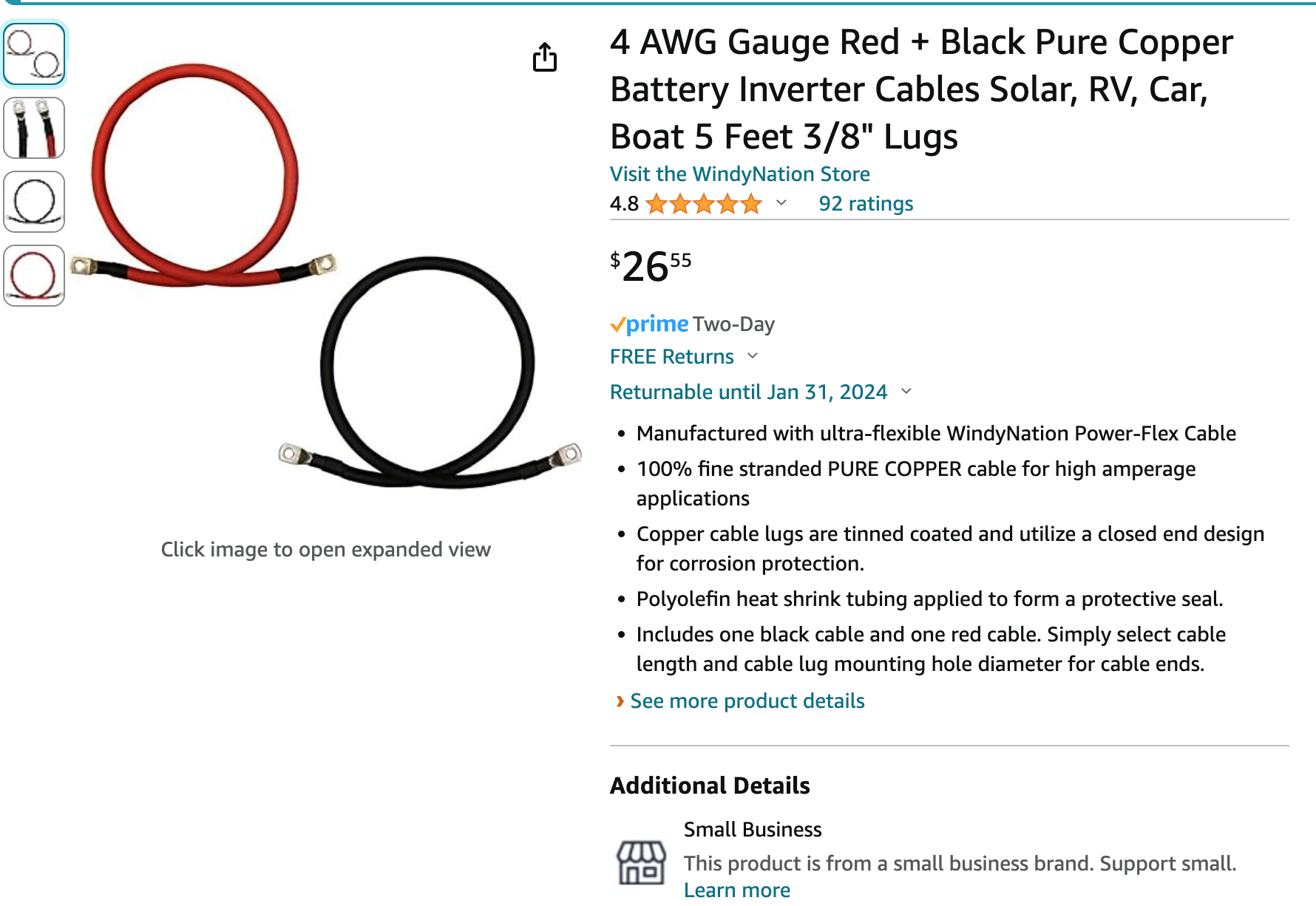

    Old thread, I know.
    I used a 1000W sine wave inverter, 100 amp fuse, 5 ft of 4 gauge wire.
    No issues. Set up for camping but rarely used for that. However, I did use several times when we lost home power.
