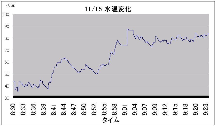

    The primary purpose of the Prius CAN Monitor is the data logging capability.
    There are some interesting data posted by 108@Nagoya to our local forum.
    They are coolant temp graphs two kinds of front grill shutting and one heater use for his 30 km commuting.
    Enjoy,
    Ken@Japan
    C. Shut grill same as above(100%) with heater use(outside temp was 14-20 C) heater setting was 25 C
    It never reach the stable 90- C level. The mileage numbers are...
    without heater: 35.72 km/L (84.0 mpg)
    with heater: 33.25 km/L (78.2 mpg)
