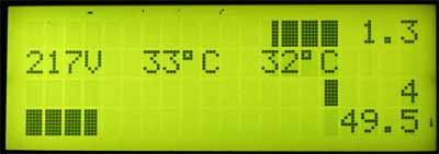

    Anyway, attached is my simple SuperMID C-1 gadget which displays HV battery amps, volage, temps and SOC plus brake/accell pedal value.
    http://priusdiy.fc2web.com/C-1.html
    (sorry, Japanese page only)
    Ken@Japan
