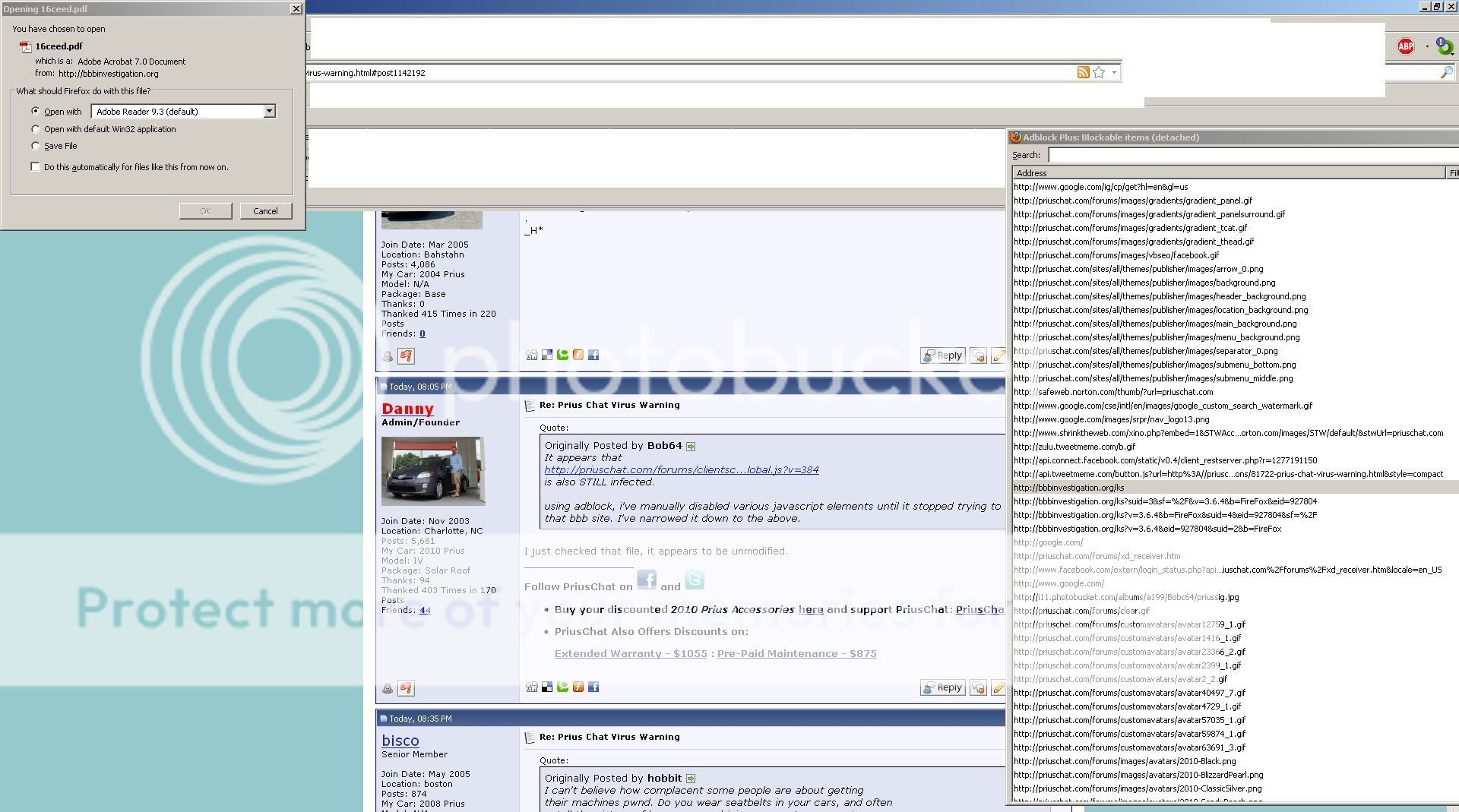

    Turns out it might have been a figment leftover from firefox's aggressive caching (and inability to reload the page).
    But to prove that I wasn't crazy and it really did try loading the thing (probably from cache):
