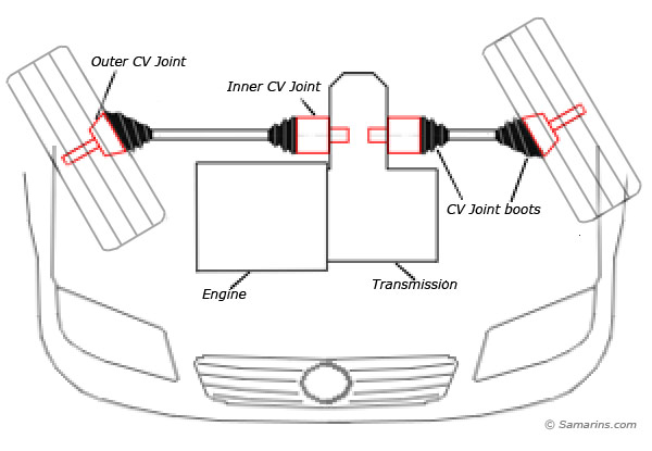

    If the noise is related to torque on the drivetrain (acceleration and regen braking) but not related to torque applied through the brake rotor, then I'd say the problem is in the driveshafts- and possibly just one of the four joints therein.
    I'd go so far as to guess that the right outer CV joint took too much of a shock. Cracked cage or one of the balls got chipped.

    These are the rotating shafts that carry power between the transaxle and the front wheels. They are double-jointed to allow the front wheels to turn and bounce while still delivering torque.
    I think there's a problem with your right side outer- leftmost in above image.
    Also potentially suspect- the right front wheel bearing, which is next-door-neighbors with the joint, surrounding the red stub you see pointing leftward.
    I would think any shop could diagnose this correctly, but possibly the place you visited may have been blinded by the hybridness of your car. That happens- they get caught up worrying about the things they don't fully understand and miss the ordinary stuff. Prius driveshafts, CV joints and wheel bearings are the same as you'd find on any Corolla, Altima, Civic, Focus etc.... an extremely common setup.
