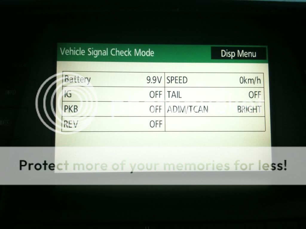

    They are $160 now. I just checked the voltage of the battery - 9.9...seems like that is a bit low. Not sure when it should be changed...but I am guessing soon?

    Yeah that's BAD. The swap is not hard but you have to be comfortable disassembling your interior a bit. If going the elearnaid route, be sure to get their kit along with the battery. Bernard at elearnaid was fantastic, shipped very fast and I had the battery next day. Heavy box!

    If the battery is showing 9.9V I would get the Optima battery ordered today. It is amazing that the battery is working at all, and it won't be for long. And if it goes dead, it will be a real pain to open the hatchback.

    Yeah, 2007, and it had to be jumped, it is definitely on the way out. 9.9V means dead. Unfortunately, regardless of the source, this battery is not your $60 Sears Diehard variety, and it will be difficult to get out for less than $150 after tax.
