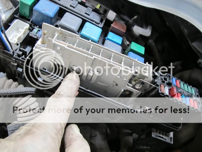

    +1 for hope it was just the fusible link that blew. But it could very well be the inverter or a host of other ECUs. Since the entire car is dead, I would say that is a GOOD sign. Most likely the main fusible link sacrificed itself for your stupidity.
    This thing:
    And it blows like dis:
    As a TEMPORARY stop gap you should be able to solder/jump it back together. But that will prevent it from being sacrificial again. A replacement is $10 to $20 and a super pain the butt to replace just because it is something so simple yet core with lots of connections. If you jump it and then never fix it and fry it again, you are looking at a $4000 repair bill for the inverter new from Toyota. A salvage inverter installed by a shop mechy will still be $1k for the part, $500-$1k to put it in.
