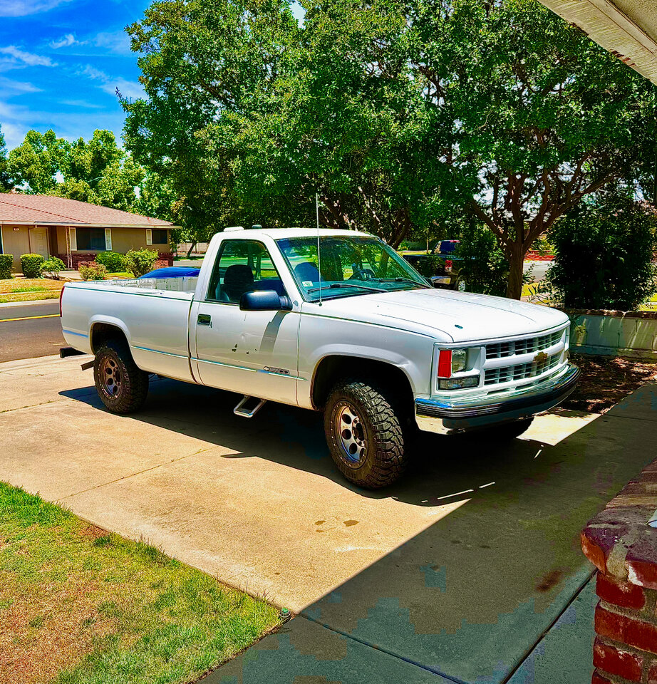

    heres a current project of mine (sorry if not allowed...have mercy)
