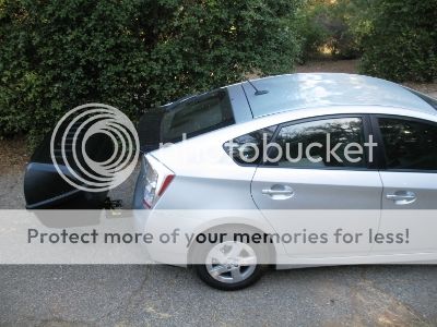

    One way to reduce any ground contact is with Firestone's Coil-Rite air suspension, as seen here on our 2011. The EcoHitch is worth the cost. U-HAUL installed ours for $60.00, they do more hitch installations in a day than I'll do in a lifetime. The Thule carbo box is weathertight, locks, and won't lose gear during transport...

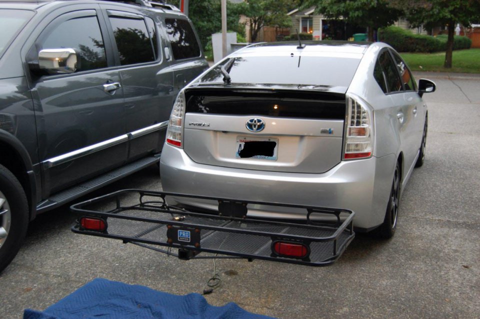

    I have the Eco-Hitch on my project Prius v, but it isn't on the road yet, so I can't comment on much. I bought it to use the existing bike rack I have from a previous car. Installation was super easy!
    I think Torklift Central would consider this a non-standard installation though. :rolleyes:

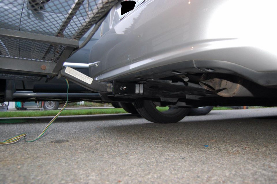

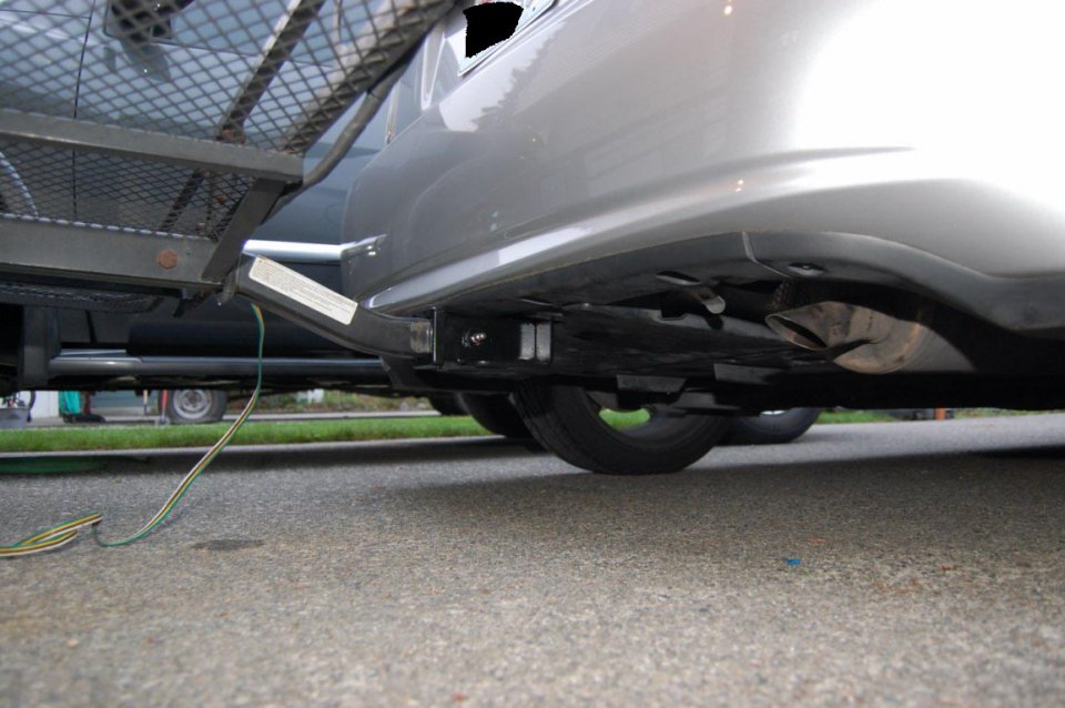

    look ma, no plastic panels.:cool:
  8. ecojay
    ecojay Junior Member
    Jul 27, 2018
    San Francisco, CA
    Do you recall what that sheetmetal is for? It looks important. I have a 2012 Plug In and looking to get either the Curt or Ecohitch. Cheers.

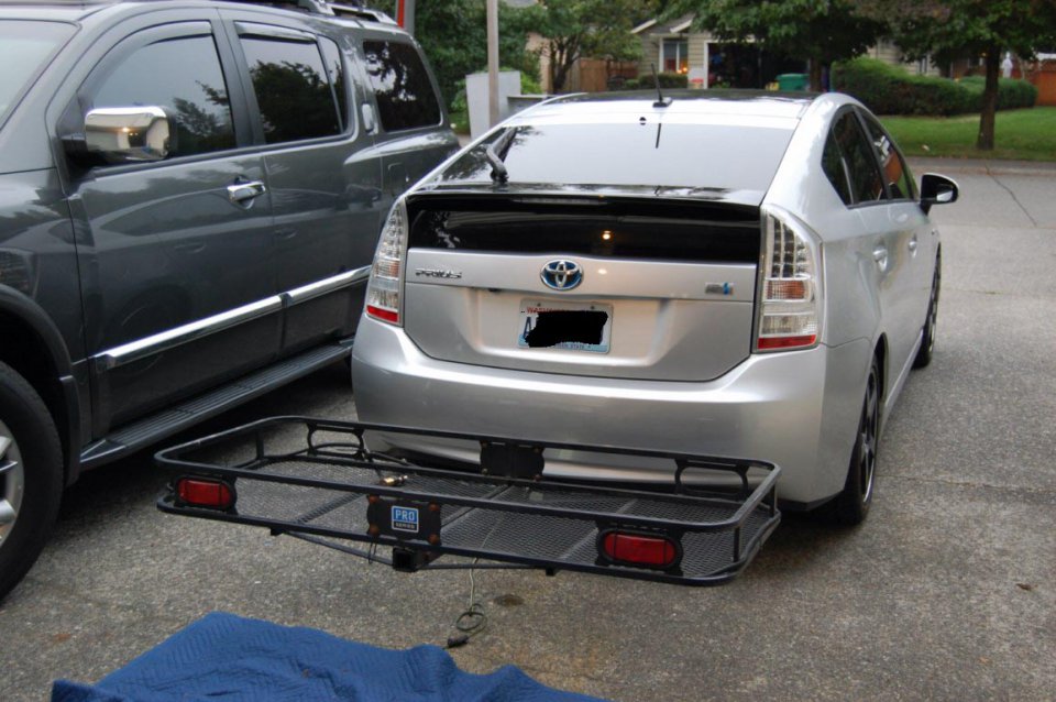

    Also, the Harbor Freight ATV Cargo Carrier fits perfectly into the profile of the Prius.
