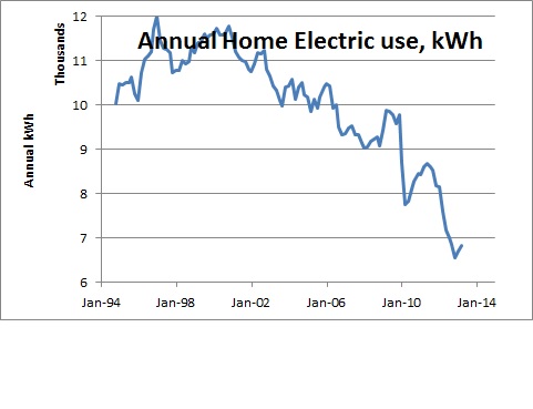

    This is not a V2G or PiP thread .. ;)
    Our first Prius came home close to 10 years ago. Not only did the car encourage me to learn about Prius, I also became more informed about energy. I soon learned (and had my nose rubbed into the fact) that my home electricity consumption was greater than my car. That prompted a decade long effort to improve my home electricity budget. Additional motivations along the way have included the problem of AGW, and my ever increasing dislike of coal.
    Without further ado, close to a decade of home electricity improvement
    Current consumption now runs 2.5 - 3.0 kWh/day after the most recent bout of energy cuts these past few weeks. This is about a 93% cut in home electricity since my efforts began in earnest.
    fuzzy1 likes this.

    There is a large crew trying to follow in your footsteps. However, you have also done a lot of (sensible) shifting to different energy sources away from electricity. That makes your graph a little more impressive to someone that might be unaware of that aspect.

    Wow, that really puts me to shame, looks like I haven't even been trying.
    I'm tracking annual consumption, not monthly (or bimonthly, the billing cycle here). I'm now down 38% from a base period of 1996-2005. While some conservation began earlier, serious conservation started in 2006, three years before acquiring a Prius.
    Note that my home is all-electric, so this includes heat, hot water, and cooking. An auxiliary wood stove is kept for power outages and ambiance, but its use is also down sharply (the most enticing times to use it are usually accompanied by burn bans from the local air quality authority), and hasn't been used in over two years.
