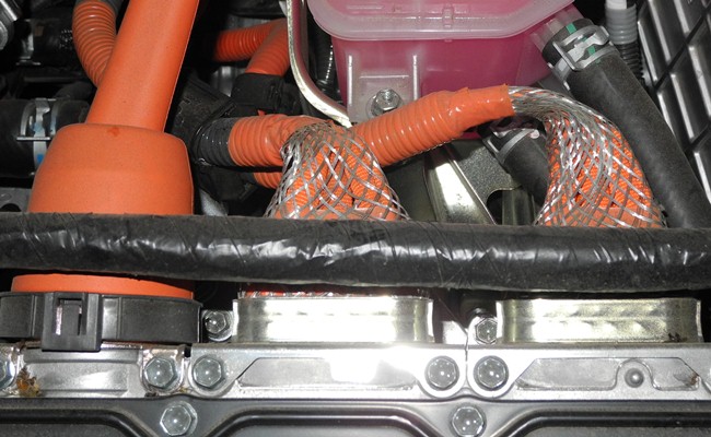

    Addressing the third point, the outer, weather proof cover is orange plastic and covers a fairly thick, aluminum shield. Take a hacksaw to your cables and you can see the cross section and solve the "very, very tired" feelings.
