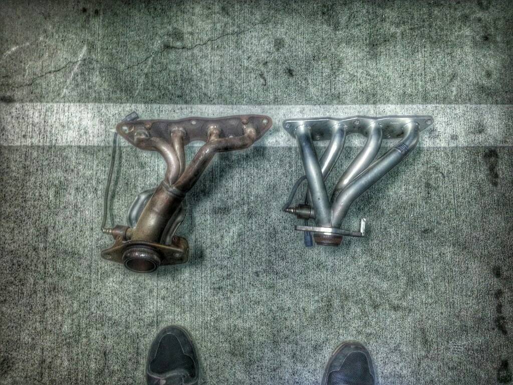

    Made some headway... more updates soon.
    Check out the thread: Modding My 2008 Touring...."JustDidIt" | Page 10 | PriusChat
    Haven't posted much in here in a while - soooo
    Got all this swapped over to my 2007 - LOVE it.
    Removed OEM 1NZFXE steel header
    Installed a 1NZFE DCSports Ceramic header #SHC4401 with custom welded flange
    Removed (1) OEM catalytic converter
    Removed (1) OEM resonator
    Installed (2) 4" round Magnaflow mufflers #10414 directly behind O2 sensor
    Mandrel bent 2" piping
    Custom dual loop muffler created from (2) 4" round Magnaflow mufflers #10414 and Magnaflow's exhaust tip #35168
    Improved flow overall with my custom intake. The hybrid battery charges up faster, no MPG update yet on my 2007 but it improved quite a bit with my 2008. Definitely feels quicker,but no dyno proof of course. Really feel like the OEM headers, the (2) cats, resonator and muffler as well as the reduced piping size really limited the potential of the little 1.5L.

    I can't single handedly prove it improved my MPG but I know with the combination of the custom intake AND the custom Header back exhaust i felt a performance increase when I flogged my car and I saw a mpg increase when I drove economical. Best run ever on stock exhaust with stock intake with OEM 16" wheels was 44mpg - I was getting constantly above 50mpg once I finished the entire exhaust setup.
    MPG depend largely on driving style, but also terrain and climate. In SoCal I was getting 41mpg with my 19s and now here in Canada I'm getting 40mpgish. During the winter which is a majority of the weather up here - I struggle to get 38mpg.
    No video yet, but found some pictures of the install..
    The one aspect that I am not happy with is the loop with a point. It will be cut off and replaced with a smooth 180 pipe at some point.

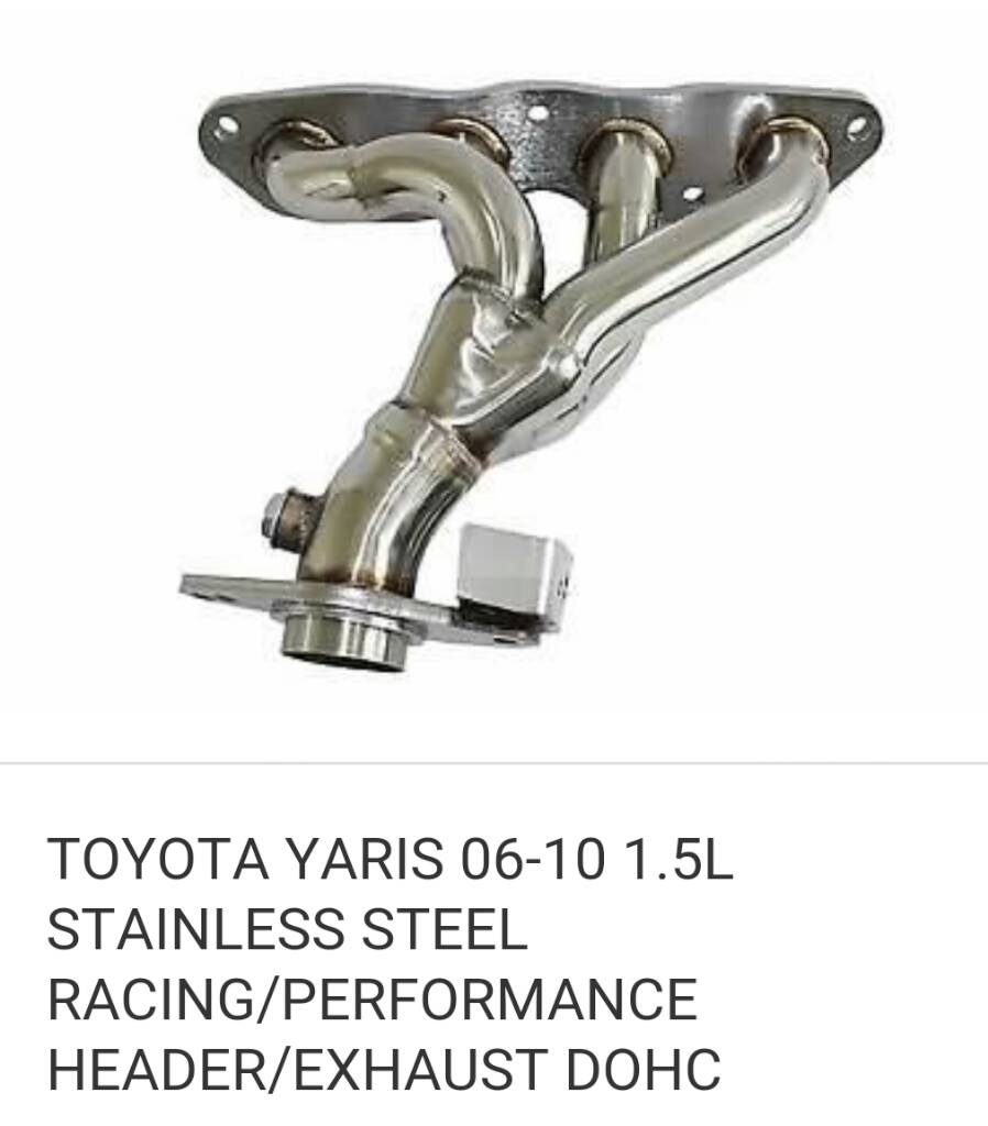

  14. Sezy

  15. Justdidit
    Justdidit LVNPZEV
    Jun 12, 2012
    1,880
    711
    75
    Carrollton, Texas
    Four Touring
    It could possibly work but I don't know if it would be much improvement over stock. That header has some short runners..compared to the DCSports.
    Keep in mind that this is not a straight bolt on and you will have to have a custom flange welded on.
    After reading reviews from other 1NZFE users, I chose the DC Sports header off of dyno results... granted our 1NZFXE would provide different results.
    The eBay one looks almost exactly like oem.
