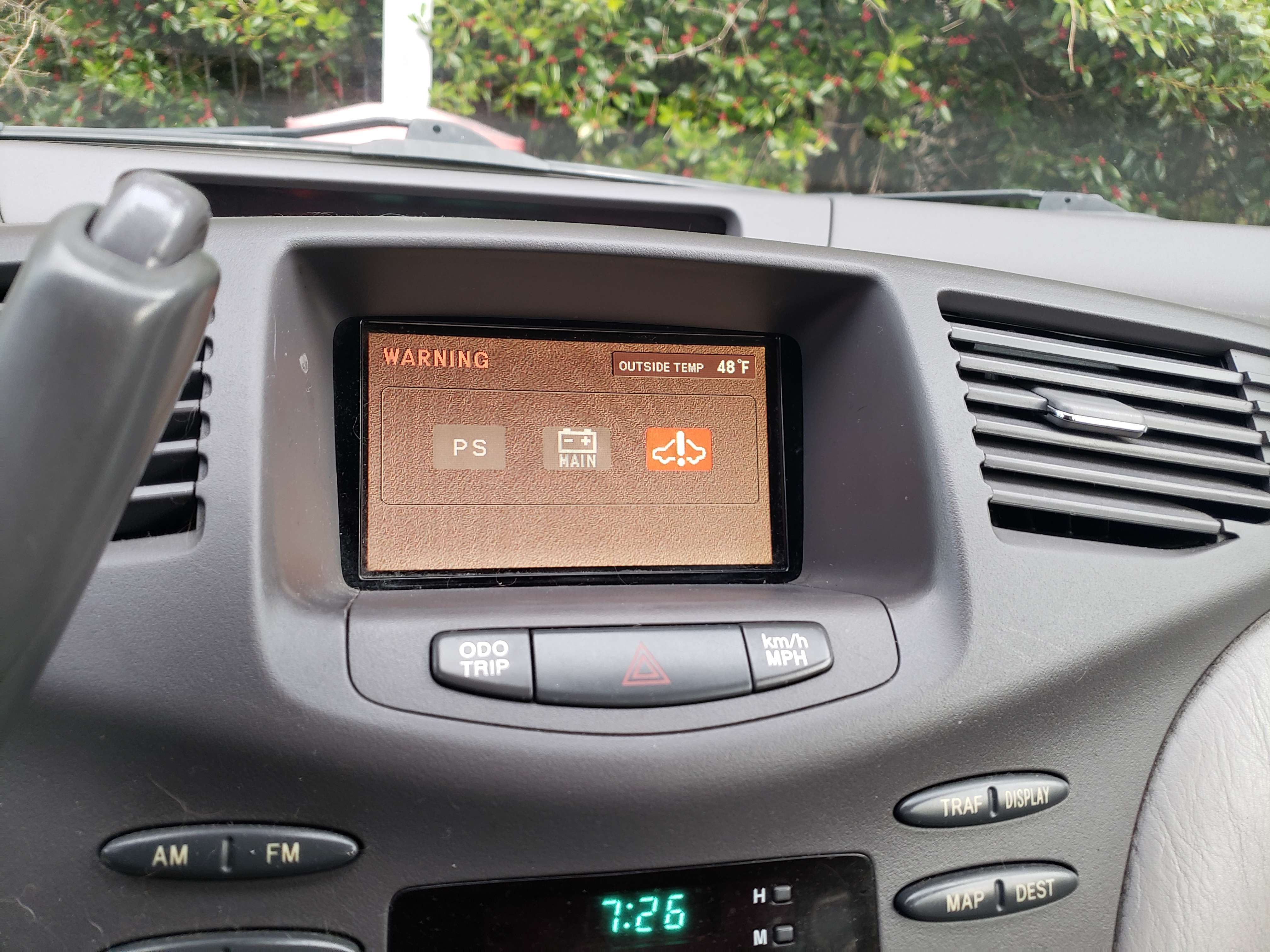

    I did not see a Gen 1 forum but have an issue with a Gen 1. My roommate has a Gen 1 Prius (2003) that is throwing a warning but no code. Is in the Hybrid system.

    PS is power steering. Main is HV battery discharge. The auto symbol means don't drive the car, IIRC. See 2003 prius dash symbols

    People often forget to say (and I agree the design is confusing) that you have to look for which of those three icons get highlighted. In this photo, PS is grayed (no steering issue), battery is grayed (no battery issue), and the au!to tells you there are some other trouble codes present in the hybrid system, not steering- or battery-related.
    Aftermarket scan tools will often fail to read codes from a Prius hybrid system. The dealer should have been using Techstream, and Techstream should have seen the trouble codes. My money is on operator error at the dealership.

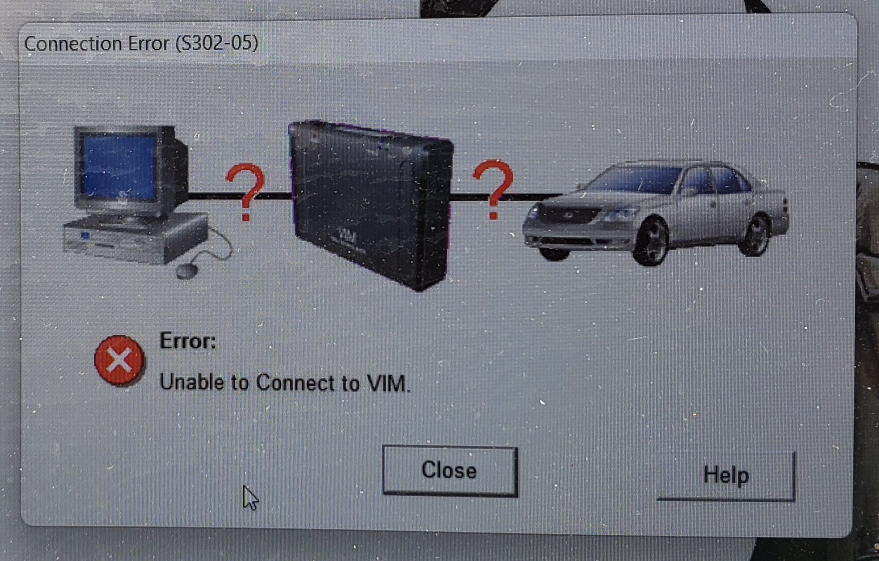

    Keeping getting this
    Figured it out. Still a royal pain though.
    #16 KitsuneVoss, Feb 19, 2023
  17. Jakob
    Jakob Junior Member
    Oct 30, 2019
    67
    17
    Wisconsin
    2003 Prius
    I think I was stuck on that same error for a while. The seller was nice enough to remote in and fix the issue. For me, the problem was the drivers for the scan tool had failed to install, so right-clicking on the device in Device Manager and choosing "Scan for hardware changes" fixed the issue.

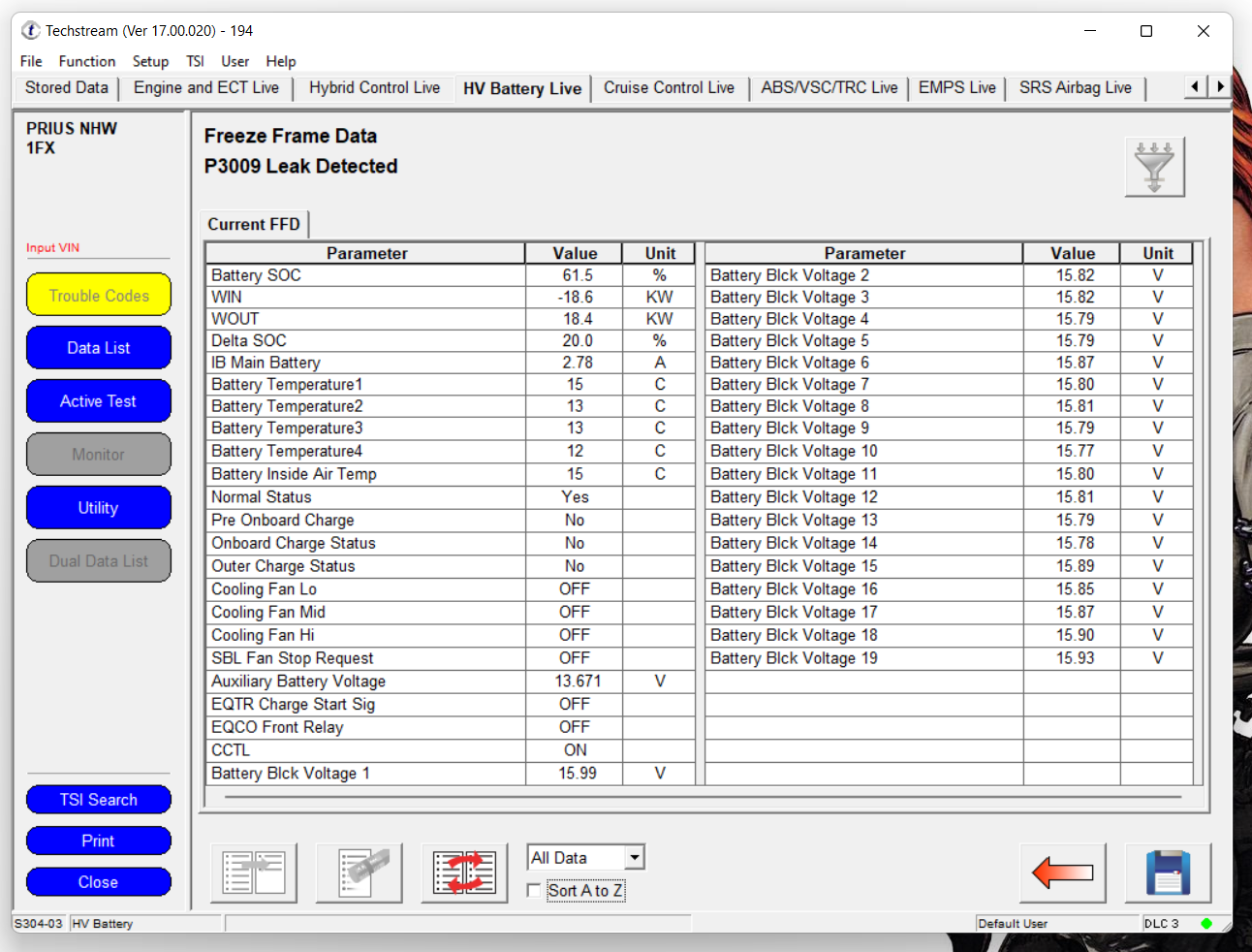

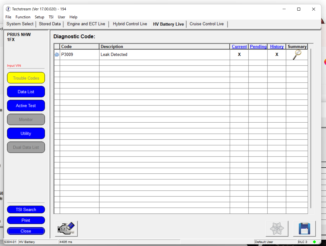

    I have codes. . . .What did the Toyota shop actually check?
  19. TMR-JWAP
    TMR-JWAP Senior Member
    Aug 12, 2016
    6,404
    6,093
    Columbia, SC
    The P3009 is pretty much identical to the P0AA6. My experience with the Gen 1 is they typically have horrible electrolyte seepage problems on the HV battery terminals. A good disassembly and cleaning could solve that problem.
