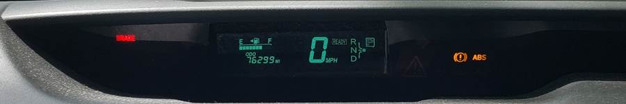

    Problem: Recently the above lights showed on the dashboard. There has been NO recent brake work, no recent accidents, no known reasons that I know of would have introduced air into the system.
    Dashboard lights(Note - VSC and "Slip Indicator Lights" are NOT lit.):
    1 - BRAKE
    2 - Brake System Warning light (Circle with parenthesis and exclamation point)
    3 - ABS
    Note: If I clear the ABS code, it comes back only "when" I press the brake pedal the first time after clearing the code, but to be clear, not until I press the brake pedal.
