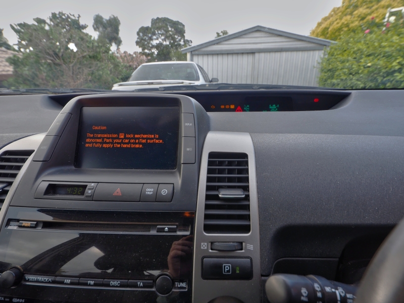

    fine yesterday
    get in it today, all the panel lights come up, and a warning on the screen
    Caution:
    The transmission P lock mechanism is abnormal. Park your car on a flat surface, and fully apply the handbrake.
    Car wont start,

    I have no idea what that guy was on about, and I cant wait the 2 yrs it might take for the gauge to be delivered
    I get 9.6v across the poles, connected in the car, but no load
    I get 9.23v with the car turned as 'ON' as I can make it

    Your 12 volt battery is very dead when it reads 9.x volts.

    ok update
    I had to check to see all was well
    Im not sure what could go wrong, shorted connection or something, whatever
    but everything seemed fine
    So there I was with the keys in my hand, I just inserted the fob
    the system came to life, this time not all the lights that had been coming up lighted
    next thing, it started!
    the park lock malfunction warning came up
    but after a few tries it selected a gear and the car was alive!
    I took it for a spin round town so that if it died I wouldnt have to walk far
    and I got about 20km on it.
    I feel it will probably be ok, but that I should get a replacement battery ASAP
    the relief! I left it on charge for until the morning
    my sincere thanks to all..
